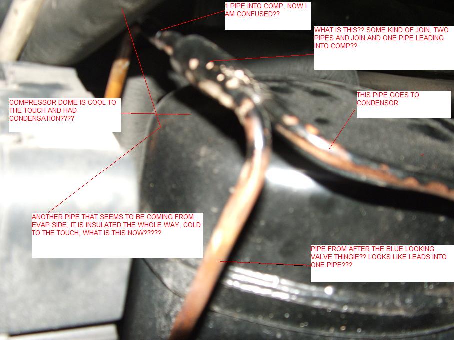

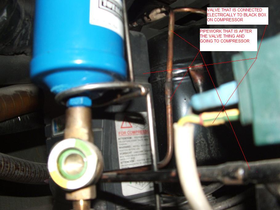

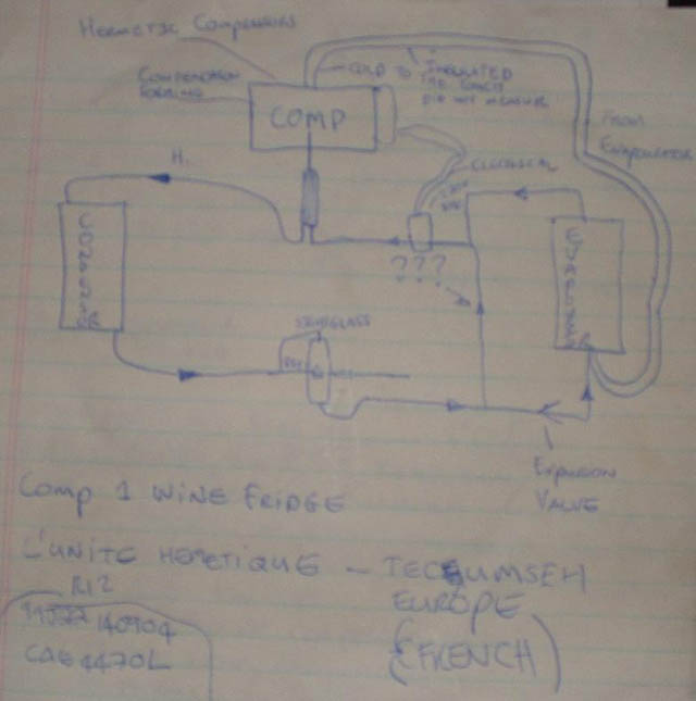

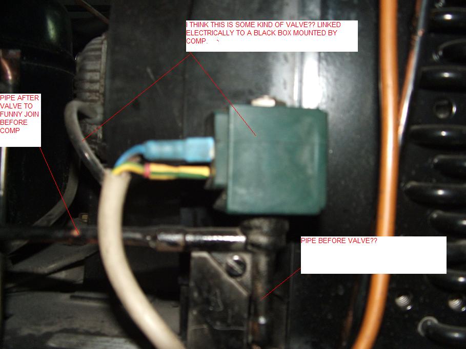

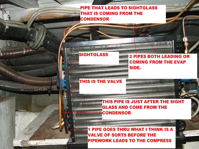

    Okay here are the pics with some notes and observations....
  20. wdrzal
    wdrzal Senior Member
    Feb 6, 2006
    415
    I can't make heads or tails from those pics. This is going to be harder than I thought. figures it would be a simple loop.
    But the large tube with the insulation is the suction,the one thats cold, thats your low side or blue hose on a refrigeration manifold.we need the suction pressure,there should be a connection on this insulated hose,may be right were it hooks to the compressor. what refrigerent does this unit have in it.
    and we need a high side pressure.around the blue filter some where they should be a high side port on a uninsulated line. I didn't see any ports in the pictures but the fridge tech was probably hooked to them.
    I,m not sure from those pics what that extra line is, it could be a defrost loop. fridges usually don't need them . could be a externally equilized tvx but the line looked big for that.
