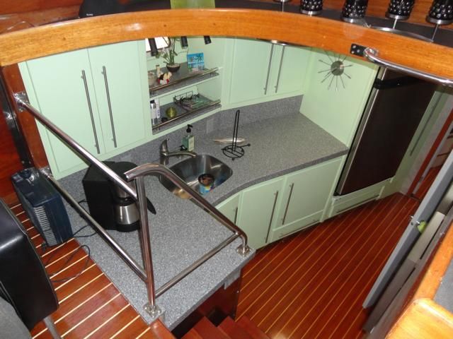

    Thank you rc,
    I dont have dimensions but do have a photo of the galley. We are going to strip the paint to bare wood and the stove will sit right next to the fridge.

    Someone went through a bunch of effort to remove the Princess stove and fill everything in. Looks nice. If you only want stove burners, I would think an electric glass 2-3 burner from an appliance store can go right in the top. I saw online for $300.
    Stripping the paint - try it first on a spot you can't see. Those doors are replaced so they may not be the best test. The wood on the walls is porous. There is a good chance you won't be able to get the paint out totally and be left with white specks. If you try to sand it all out, you will probably go through the veneer and not like what you are left with and repaint. The walls are not solid wood, only veneered plywood.
    If you want a nice teak table that is really close to Post OEM, try here: http://www.arrigonidesign.com/tables/ but the price...

    congrats on your new Post
    The pic looks great, I really like the teak and holly
    go with a cook top
    and a microwave combination convection oven.

    Nice looking photo and congrats on the new buy!
    Not to get too far off topic but I have an electric cook top on board my OA. Most everyone I speak with say to ditch the electric and go Gas. I like the no gas to deal with and don't find it too awkward to fire up the gen when we're cooking. Also, nice clean look. Thoughts from the rest?

    That is a pretty pic. Thx for sending. Send more. Lost of great Post threads here that are full of great info.

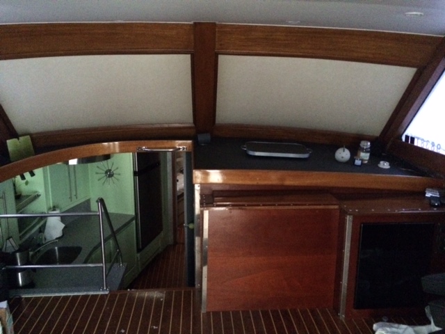

    Hey Guy's,
    I have to tweak the salon since the boat has been out of the water for 3 years. What would you recommend? Use a finish after light sand, oil or a kind of polish? It's in pretty good shape with a few light spots. If finish what do you recommends or oil?

    From the photo, your woodwork looks pretty good. Maybe just wax?? But what to do really depends on what "look you" want. There are always the semi gloss and stain varnish finishes, but there is also the rubbed tung oil finish. There are plenty of videos on the rubbed oil. I've done my outside teak chairs and table with that procedure and gotten many compliments. I used WATCO Danish oil which is a mixture of tung and varnish so it comes to a hard finish.
    BTW, I sort of like that light galley. Brightens the area? If you wanted some color you could roll and tip...

    Ricky,
    your 42 Post is very nicely done.
