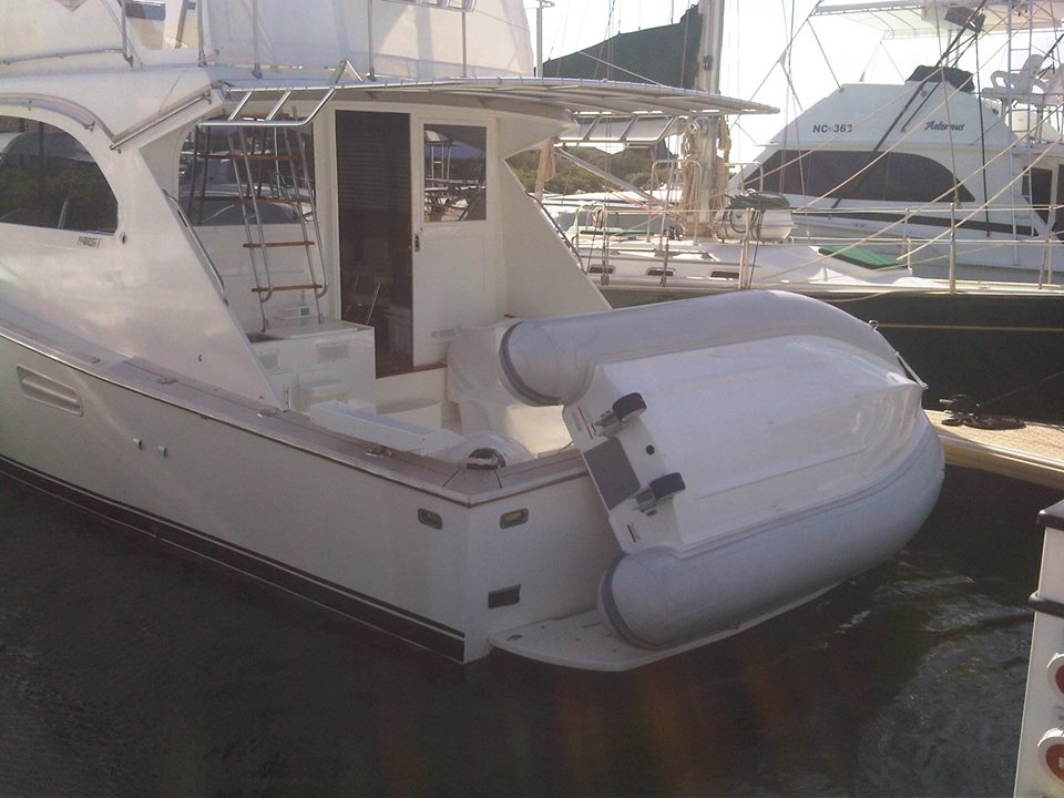

    Mounting a 11ft dinghy like this, is much easier in my opinion!
