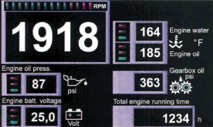

    Are you are referring to the engine in the title of this thread?
    If so, being 100% mechanical, it wasn't supplied with the engine control display (aka MMDS, in MAN jargon).
    It could be retrofitted, though imho it's not worth the hassle at all.
    In fact, it would miss a lot of data anyhow, either because the engine didn't come with some sensors like the EGT and turbo pressure probes, and/or because such data is only available from the ECU, like load, fuel burn, and also the engine hours. ECU that the engine just doesn't have!
    So, having said that if you have the LE403 V8s with the MMDS displays you'd better expect just a fraction of the data they are supposed to show, here's how the page that includes the engine hours should look like... MMDS page.jpg

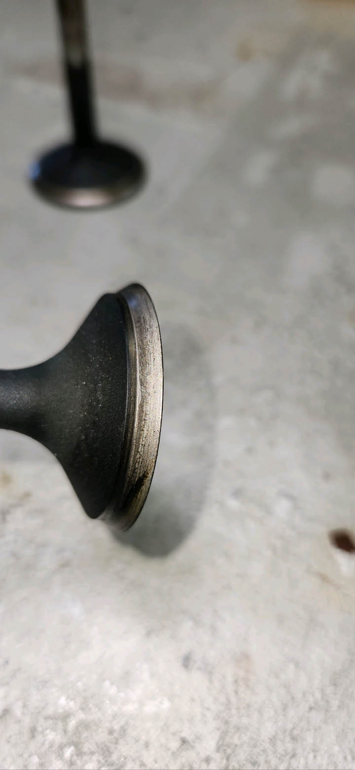

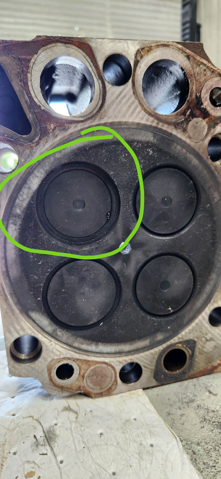

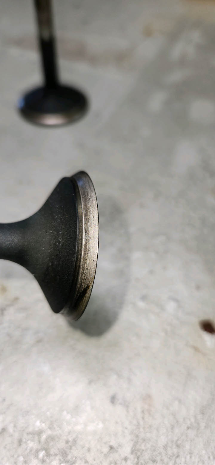

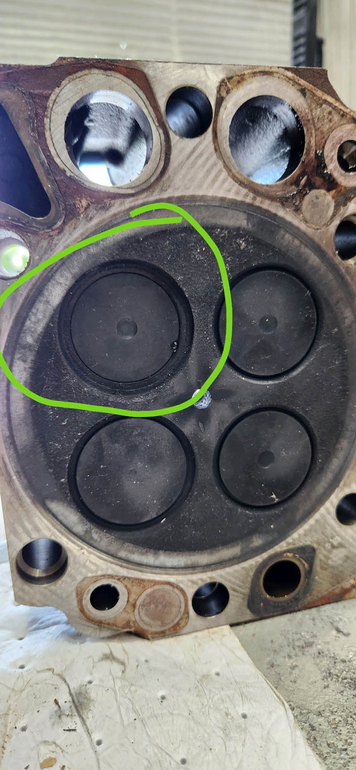

    Ben, do you have any pictures of the worn valve ? thanks.
  17. Ben Cooksey
    Ben Cooksey Member
    Oct 10, 2020
    45
    Mobile AL
    Mod Edit: images reduced to fit our format. Please read the rules on image sizes.
  18. Ben Cooksey
    Ben Cooksey Member
    Oct 10, 2020
    45
    Mobile AL
    The first photo is the head with the circled exhaust valve that was measuring very high during the valve lashing. The second is the worn valve. The third is a normal valve. Im fairly certain previous owners skimped on maintenance.
  19. Capt Ralph
    12,788
    This afternoon, next week or month, but sometime in your future; That valve was going to come apart.
    Uh Oh !!
    It was very smart to dive into this now.
    IMO, CYA; New valves and seats for the whole engine.
