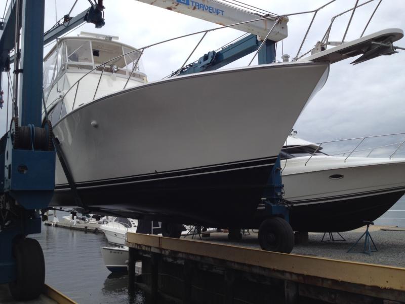

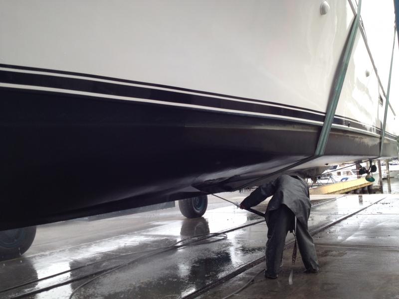

    Had zincs changed and pressure washed, I think I may have to try prop speed, next time. I felt like it was a tire change at a Nascar race, in and out and back at dock in an hour and forty minutes.

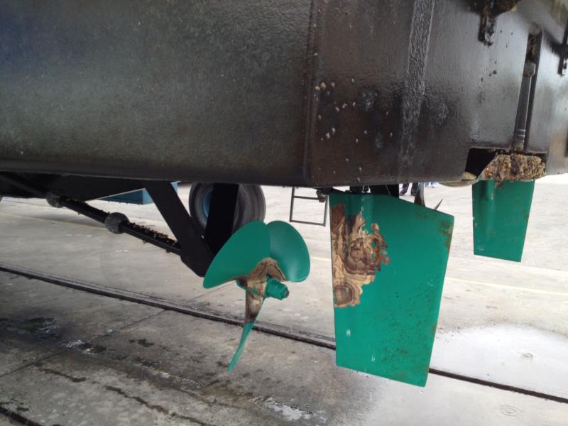

    I did not put a lot of hours on the Post this season and ended up growing a barnacle farm on the props and shafts. it took me over an hour with the hooka last month to clear the props and shafts before a trip out east.

    I had stripped the bottom and barrier coated it last season, and have noticed through my years in the marine business, that most of these divers get a little too aggressive when they are cleaning the bottom. If they catch a little nub in the bottom paint they always seem to take some paint with it, I have a friend who had his boat hauled for the winter last fall and I noticed the same kind of paint chips and nicks from divers work. I will pass on that, most divers get 100-200 to clean the bottom on a boat this size and depending on how bad it is, and what ever they get to change the zincs. I was in and out for under 500, and was able to visually inspect everything on my own for some piece of mind. Not to mention all the through hulls or engine pick ups were checked and cleaned.
