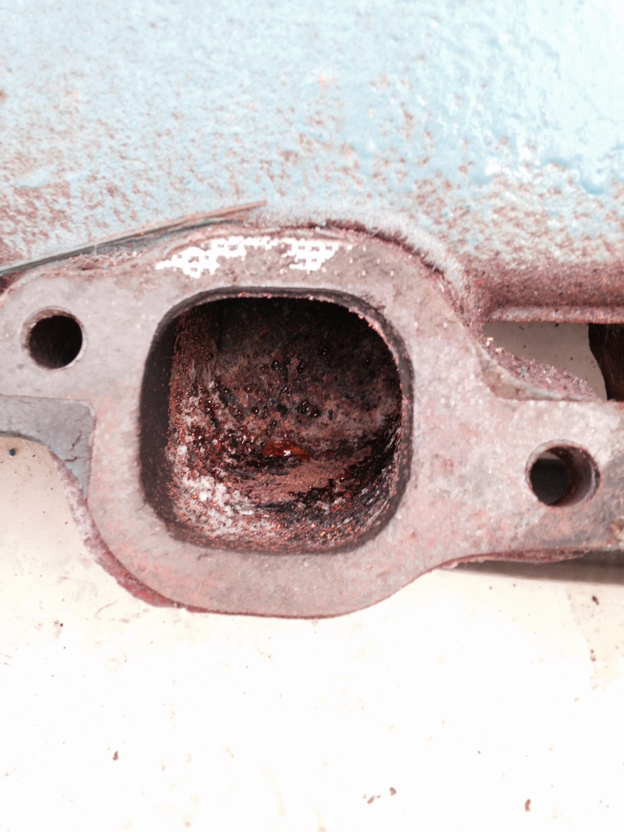

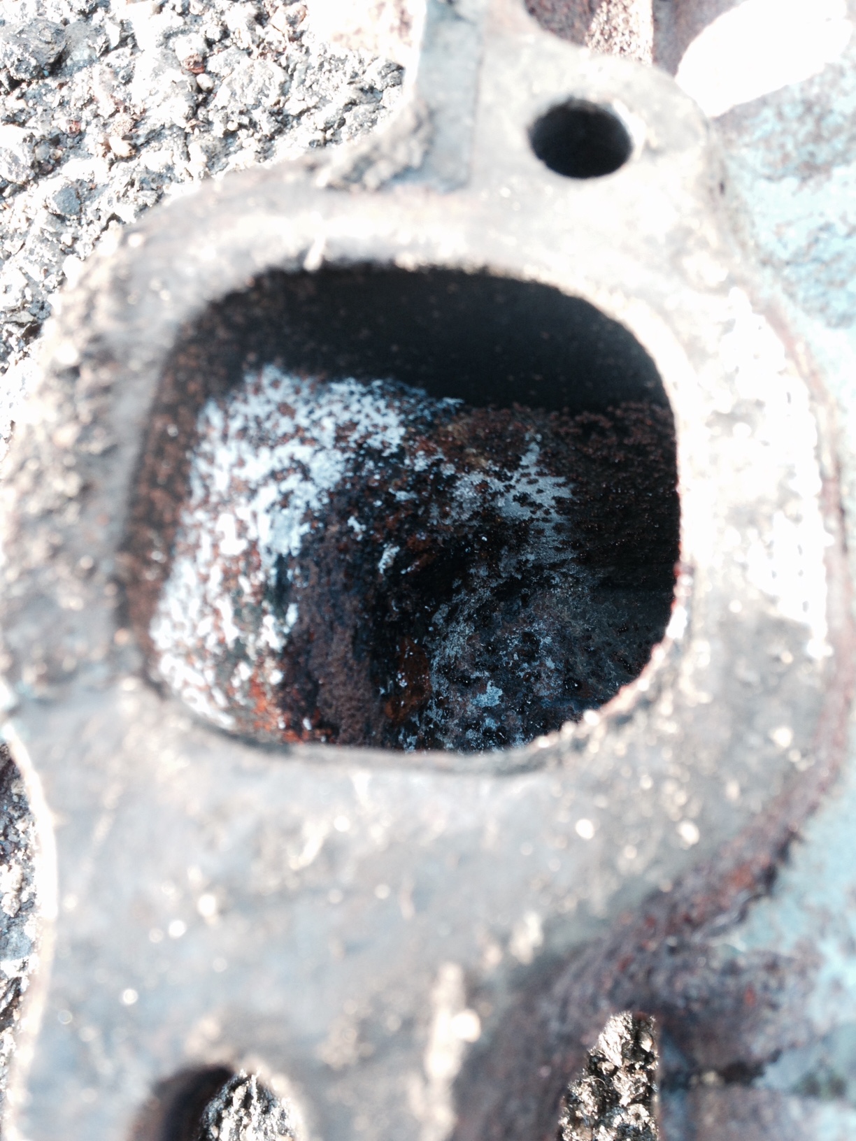

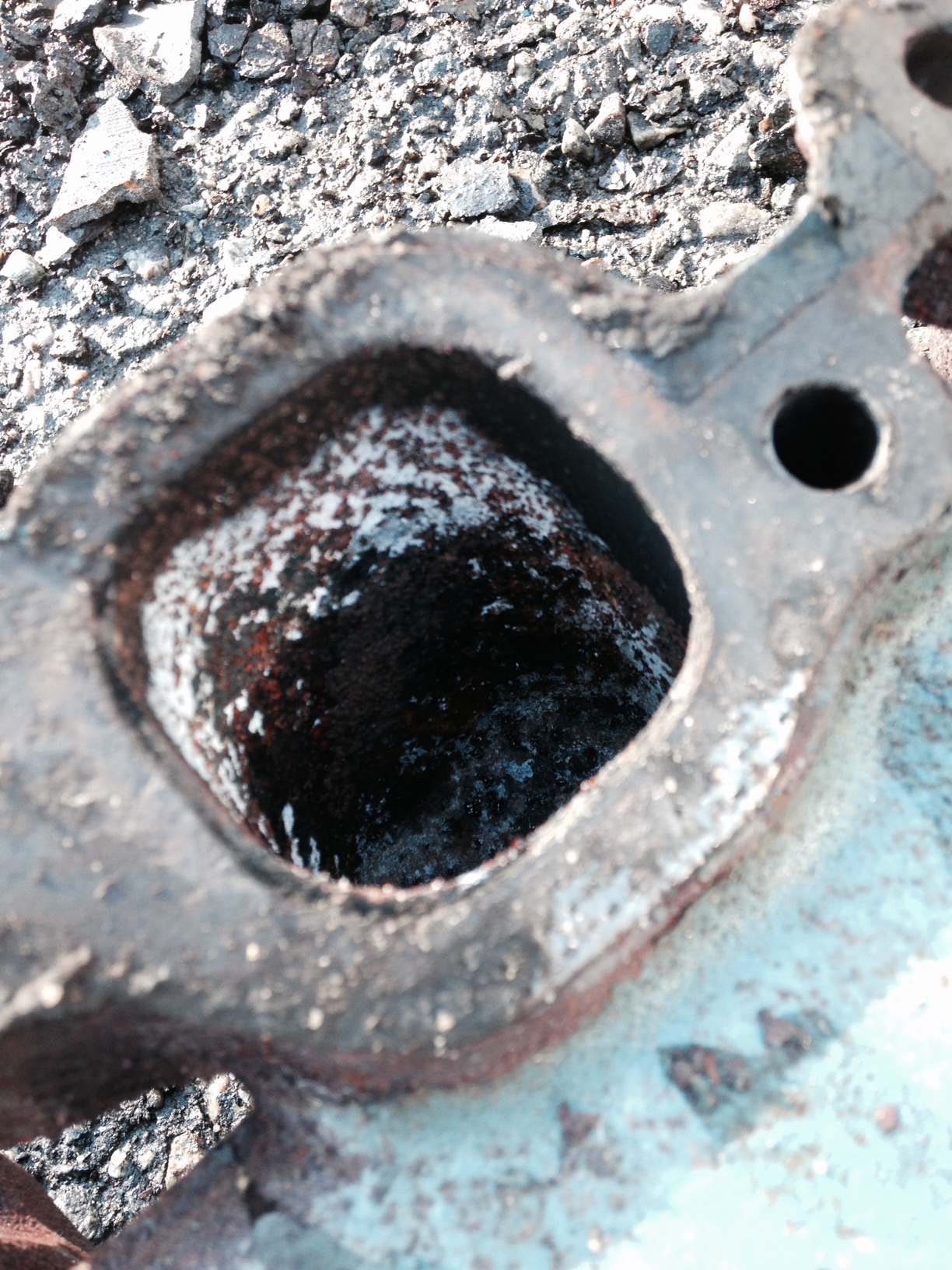

    I was skeptical about replacing my manifolds when changing out my risers, because I thought, "anti freeze is non corrosive, so why should I piss away the money."
    That changed my mind when I pulled one off and found that water seeped into the exhaust port exposed to the engine valve. (See Pictures of pulled manifold). Now if I would have let this go, I may as well lost my port engine from corrosion or hydrolock.
    The moral to this story/ lesson, is to change your FWC manifolds once a decade, EVEN though they are fresh water cooled. I hope that this was useful for you.

    Was there a rust/water trail from where the riser bolts on?
  3. Beauregard
    Beauregard New Member
    Oct 12, 2014
    21
    Massachusetts
    No, didn't see any residual signs of rust trails.
  4. Capt Ralph
    12,748
    Your pictures represent what I usually see when the riser / manifold gasket is leaking.
    You are correct, any exhaust should be closely examined often. 10 years later is a good even for a FWC log. It may have gone longer but why take any risk. It gave 10 years of good service. RIP
