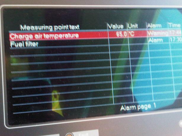

    Good evening,
    I have MAN 1100CRM engines. I am receiving a "Charge Air Temperature" warning on my port engine and the charge air temperature increases to 65 degc at 75% engine load. The charge air temperature of the starboard engine at the same load is 56 degc. When slowing down the charge air temperature on the port engine drops to approx. 59 degc.
    Any ideas what could be the cause of this warning?
    Thank you........
    Tarek

    Hi, the engines have raw water cooled intercoolers.
    The fuel/water separator alarm appeared about 15 minutes prior to the charge air temperature warning, but does not clear when slowing down. It only cleared when I drained the fuel/water separator.

    The reason I was asking was the Fuel Filter Alarm didn't say if it were Water/Blocked or Temperature related and I was thinking if you had two raw water cooled things and both were alarming at higher loads it would point a bit closer to a SW Flow problem which could range from a blocked sea water filter, a worn or defective pump to grass or some other foreign body restricting the passage ways in the cooler(s).

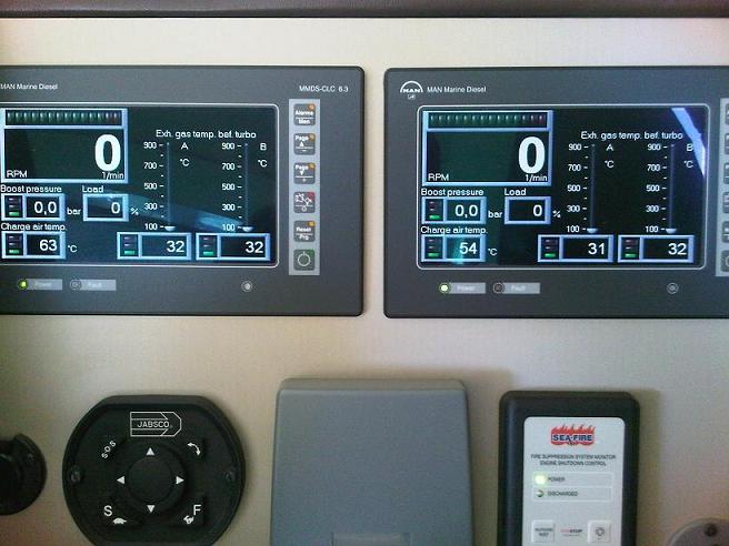

    Like you mentioned above, it's most probably a bad sensor. With just the engine ignition turned on the following day and without starting the engines (cold engines at ambient temperature), all the engine temperature sensors, coolant, oil, turbo air,...etc. were reading 31 degc, but the charge air temperature sensor was reading 63 degc.

    Before shelling out for a new sensor you could try swapping the sensors one engine to the other and see if the error transfers to the other engine.

    The sensor will be replaced under MAN warranty, therefore it's the responsibility of the local MAN dealer.
    I suggested to the MAN dealer we swap the sensors, but they thought it is better to replace them immediately. The removal of the sensor involves removing the expansion tank and they would like to do this once with the new replacement sensors.

    The various engine temperature readings..........
