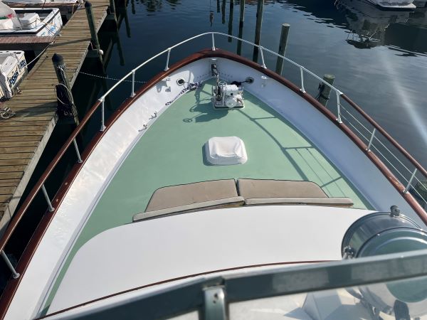

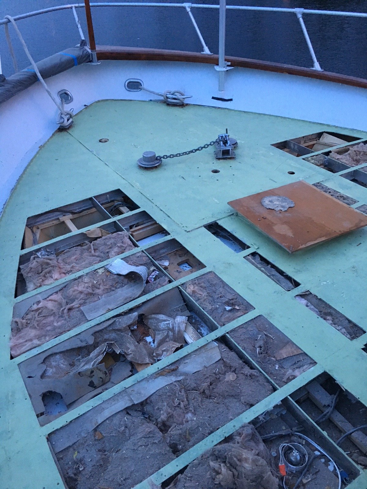

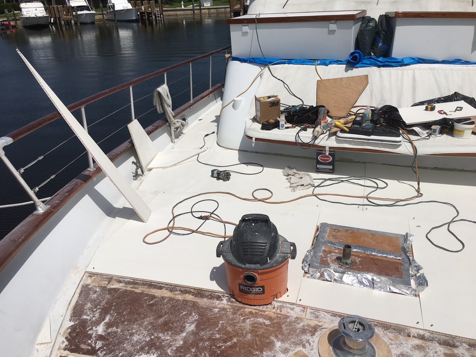

    The sundeck of your teak is plywood, and that's going to be rotting given leaks. Below that is aluminum plating that does not create a complete layer. I stripped my deck, removed the plywood, cleaned and coated the aluminum, and then re-decked with marine plywood (resin coated) and topped it with Nydacore panels that had fiberglass pre-laminated. We cut the panels into place and then ground and fiberglass taped the seams. The edges were sealed with 5200, and all was fared and painted with non skid. The result was a dry deck, no maintenance, and far less heat transferred to the staterooms below. I love teak decks. I don't like the maintenance, and mine was shot.

    If the teak is shot, really good chance the substrate plywood is gone as well. The teak is not going to be salvaged if the plywood needs to be replaced. You can strip the ceiling in these areas and inspect the plywood from beneath, as you can see from the photo. I simply made the decision to actually spend less, do it right, and avoid the battle of care going forward.

    Mine is 1980. I saturated the ply in resin, bedded it w 5200 as well as fastened it with screws to the aluminum. Provided a solid and complete surface to bed the nydacore with 5200. No fasteners. Glassed the seams.

    ….butted the sheets together with cabosil, used same to infill under the cleats or any other gaps. Took the opportunity to have the windlass refurbished. New hatch, new teak trim for both.
