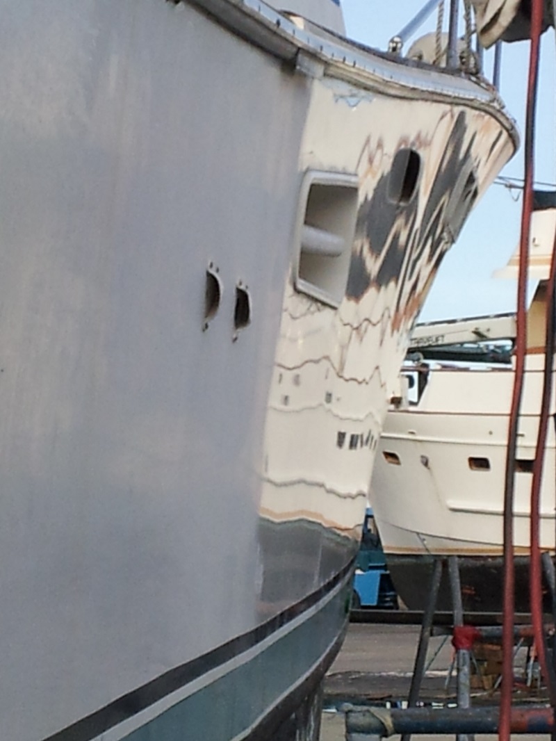

    So had the old girl hulled out for bottom paint, and thinking about spending a couple days putting a shine on her.
    what do you use?
    I've seen may products that claim to bring back the old gel coat, looking for
    personal experiences...
