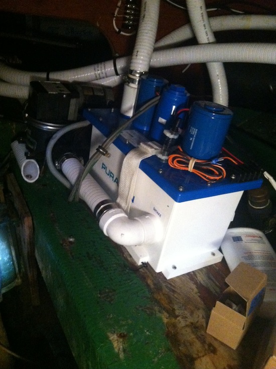

    Here is the new Raritan Hold N San system that will work with my existing holding tank ... render the waste harmless and send it overboard.

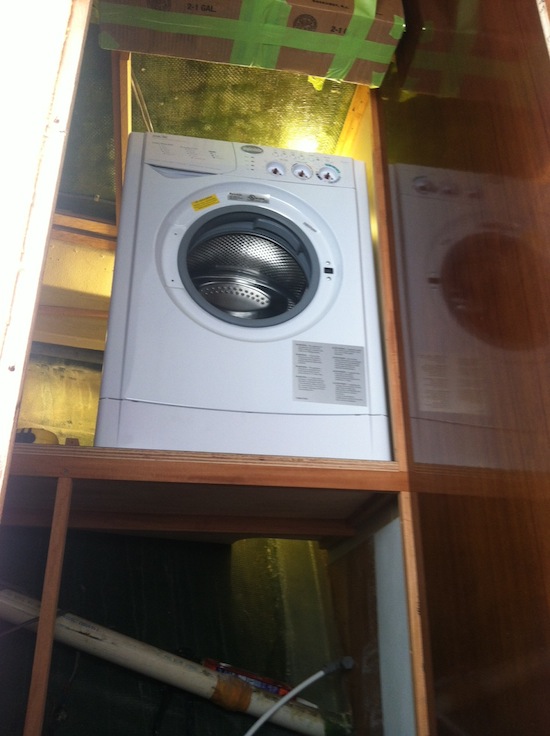

    Then I removed the forward v-birth head and pump, countertop and vinyl covered walls. Here is the new Spendide XC2100 in its spot. It's fully vented so should deliver adequate performance.

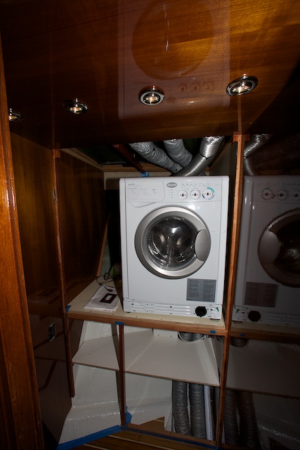

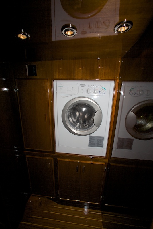

    The Spendide Washer/Dryer unit almost fit through the forward hatch ... but not quite so forward hatch had to come off as well as the trim around the now laundry room door. The new laundry room will have teak walls and ceiling with Vimar lighting. Storage to the side of and below the washer/dryer unit. It's also designed so the washer/dryer unit can be easily removed for maintenance. A new natural teak and holly floor finishes the room off. Ultimately, I will begin taking this nice flooring through some other parts of the cabin.

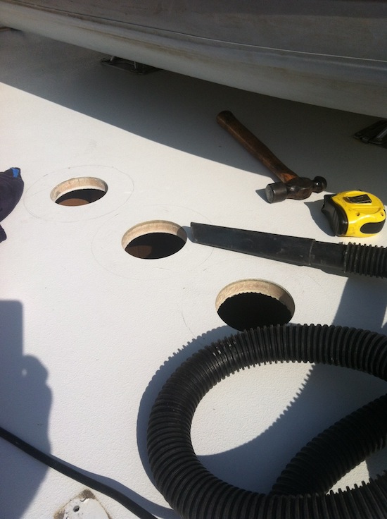

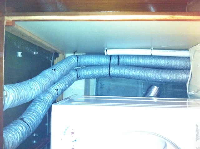

    I've opted to vent the dryer to the foredeck using a Vetus Dorade vents. There was unused space between the liferaft and the dinghy.

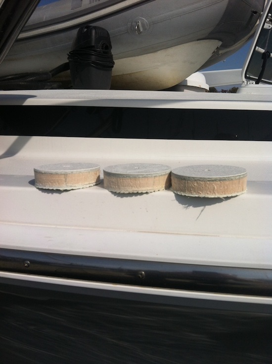

    I'm happy to report that the foredeck balsa core layup from 1984 is in perfect condition! No delamination.

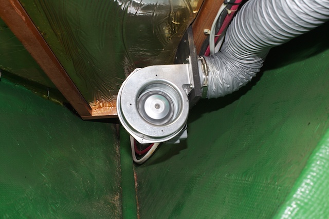

    The other two Vetus Dorade vents are for a new ventilation blower system for the forward bilge. It is designed in such a way to create a vaccume in the forward bilge so any odors are never coming up into the cabin.

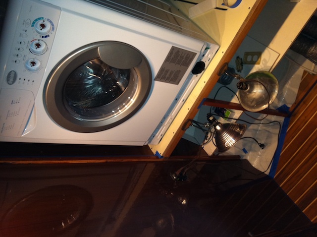

    Here is the installed bilge blower. Should keep the forward bilge aired out and odors gone. Also, the Splendide 2100 ready for testing and then finishing the installation. It will be surrounded by teak cabinetry. I'm ready to get back to my marina now. As usual, the work has taken too long.

    Laundry room complete. They turned that nasty stinky unnecessary 3rd bathroom into this gorgeous space. They also designed the installation so the washer/dryer unit can be easily removed for service. The bilge fan (separate project) is one of the best things I have done to the boat. Climbed into the forward bilge this morning and there is no smell! The odor used to waft up into the cabin ... smelled like somebody crapped the bed. No more.
