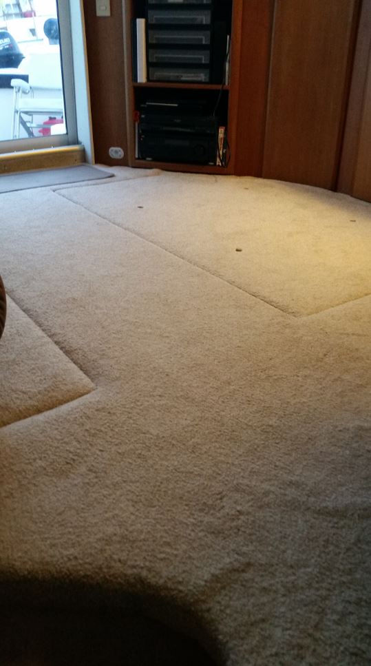

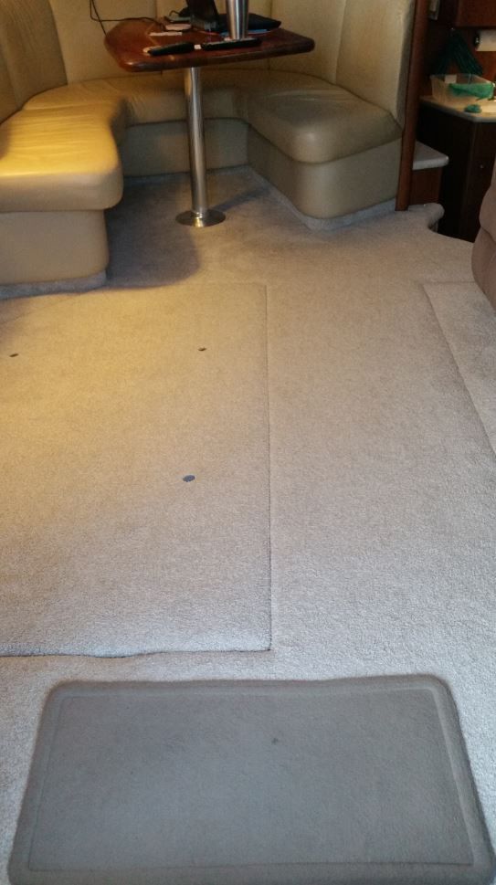

    Our boat was originally "wall-to-wall" carpeted in saloon and staterooms (decent quality), with Amtico "wood" in galley and head.
    A couple years ago we replaced the original carpet/padding with newer/better carpet underlaid with Soundown. The carpet/Soundown "sandwich" (?) section over each engine room hatch is free-floating within the overall "wall-to'wall" installation, so we can lift and move each 30-lb carpet/Soundown pair and each 30-lb hatch separately. I think the Soundown slightly attenuates engine, AC compressor, and freshwater pump noise, and the extra cushioning is great!
    (During our brief fishing season, we cover the saloon carpeting with a runner, Sunbrella I think...)
    We use outdoor Corinthian Carpet segments, cut to fit and bound with Sunbrella, over the Amtico... same as our cockpit and bridge carpeting... powerwash it all outside from time to time... and extra cushioning there helps, too.

    Ranger, I've read good things about soundown. Could you post a photo of your salon floor if you get a chance.

  19. ranger58sb
    ranger58sb Senior member
    Aug 20, 2013
    825
    Chesapeake Bay, USA
    He ya go; sorry it took so long to figure out how to do it from here...
    Since our carpet flows to the stairs down into the galley, we felt we had to go with a wall-to-all installation. Otherwise, a free floating bound solution may have been OK.
    Even so, our original furniture included a sleep sofa, too heavy for me to easily move by myself in order to clear an engine hatch... and it wasn't long enough for me to stretch out on in its normal configuration anyway... so we bagged that in favor of two electric recliners. In both cases, on top of both the fixed carpet and the floating engine hatch carpet.
    -Chris

    Thanks for the photos. I would like to go that way to ease engine and other mechanical access.
