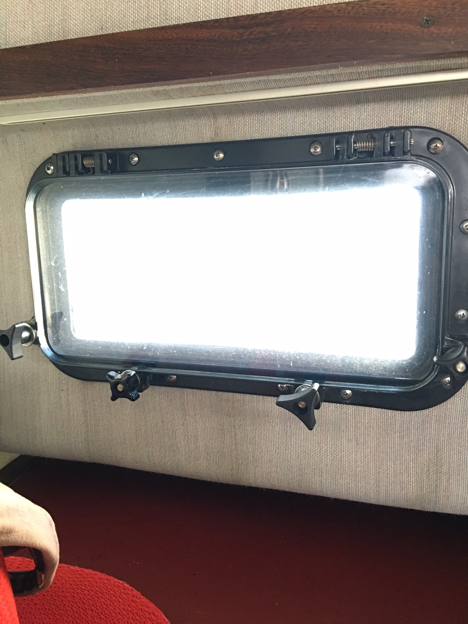

  19. HughCar
    HughCar New Member
    Mar 19, 2018
    3
    Ottawa
    I have a 2807 Riv (1983). I need to replace a few portlights. They are plastic, with the name Gray Enterprises Tampa FLA. They have springs as you can see in the photo. Size: 17.5 x 9.5 outside flange and 15.5 x 7.5 is the actual hole size.
  20. leeky
    leeky Senior Member
    Jan 2, 2011
    381
    Florida
    Hey, HughCar. DustyBottoms hasn't logged onto YachtForums since October 25, 2015. So, he might not be contacting you. Do you know a telepath?
