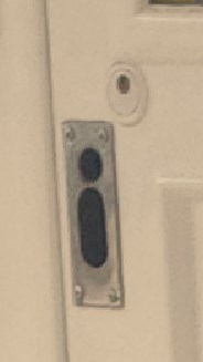

    Hi
    I am doing a lot of work on my 46' post , and having a hard time finding the correct mortise sliding door latch lock assembly,it seems my door is drilled for an assembly that has a backset of about 2.5" and the knob and lock are 3.5" on center,any other post owners have the same issue?.... Unfortuneatly the previous owner removed it and can't find it along with the 70-75 degree angled fly bridge ladder bases...I have looked every for the bases,but haven't had any luck...any help would be appreciated

  8. P46-Curaçao
    P46-Curaçao Senior Member
    Mar 8, 2013
    734
    You mean something like this?
  9. deanpe
    deanpe New Member
    Apr 19, 2011
    24
    Hollywood, MD
    I went through the same search when I got my '82 Post 42 about five years ago. I finally found the exact replacement at Merit Metal Products, Warrington, PA. I ordered the Sliding Door Lockset #1786C-FL-RH. However, I had to reuse the exterior portion shown above because the one that came with my order was too shallow. You can reach them at (215) 343-2500. I don't see that part listed on their website, so it may be a special order. As I recall, the cost was close to $400.
  10. Matt46post
    Matt46post Senior Member
    Apr 27, 2015
    226
    El dorado hills california
    Thanks for the info guys,Post yachts referred me to Merit metals and they referred me to brassworksinc. They can build me correct one for $ 1055.00, I think I'll fill the holes and buy a five oceans for $105.00, mine actually has knobs with a deeper backset than what seems to offered off the shelf today.
