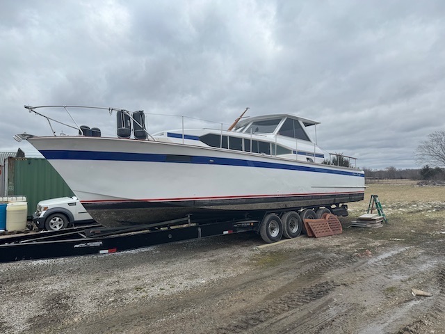

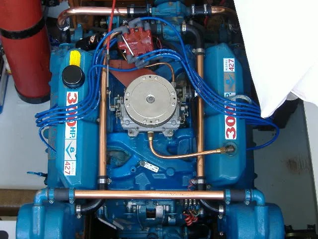

    Looking for recommendations for what I should or should not consider while I have my (2) 460 fords out of the boat to be completely gone through. I would like to make them as bullet proof as possible and dependable without changing anything to much from original.
    Both motors are original to the boat along with the Paragon HJ7 transmissions. Im sending the transmissions off to a mechanic who would specialize in paragon s as well.
    This is a fresh water boat in midwest. Im considering deleting the closed cooling system and just relying on the raw water cooling to simplify things. Any thoughts on that?
    Any suggestions on steering linkage as well. Mine is tough to turn in certain spots. I was thinking about upgrading steering from manual linkage into hydro system possibly but would rather keep original if I can get it to be much smoother.
    Also any suggestions on a bilge paint for the aluminum hull? The original paint/coating is flaking off. Im hoping to power wash and degrease well enough to prep surface for a bilge coating that will hold up and make clean up easier.

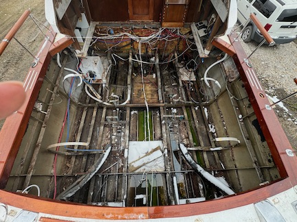

    Open to any other suggestions you all might have while the floor is out and bilge is completely empty.
    Thank you all for taking the time to respond.
    Mike

    Closed system cooling not only keeps green water out of the engine, it also helps keep everything (EVERYTHING) at a constant and efficient temperature.
    Keep the closed system if you can.

    Bilge paint, Ive worked on Strikers and Roamers. Nothing beats clean and bare aluminum.
    If you must paint; strip, then etch all the alloy surfaces, epoxy prime and paint with a two part paint.
    Consider adding bilge lights everywhere to show off your clean/shinny bilges.

    I'd keep the closed cooling. It's worked OK for 55+ years, right?

    Lake water will corrode those blocks from the inside out and the cold Midwest winters will find any water you manage to leave in the low spots and make little pieces out of big pieces. I definitely would not remove the closed loop system. I'm surprised the vibration didn't alert someone before the shafts wore through the cutlass bearings into the struts.

    My mistake! They are 427 blocks. The 460 is on another project of mine right now! Apologies

    CORRECTION: THE MOTORS ARE 427 fords.
