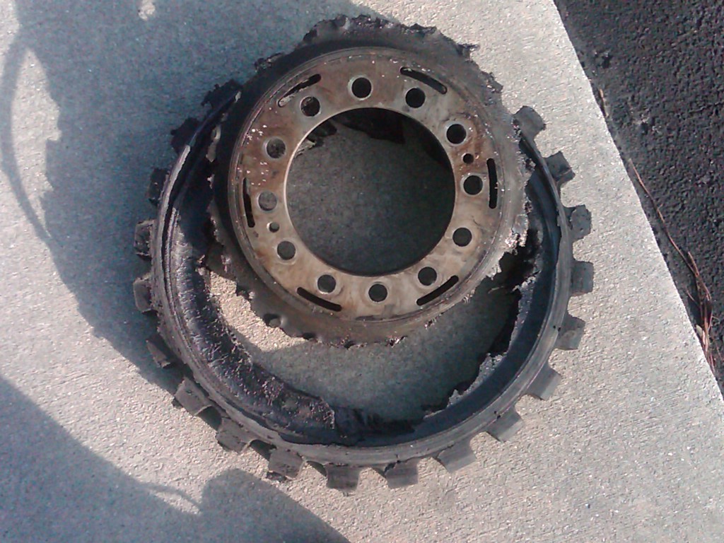

    It appears I need to have the torsional coupler replaced. It hasn't gone out yet but getting a lot of black dust & specs on outboard of starboard transmission.

    You don't need ZF for replacing your flexible coupling. Any good pair of marine mechanics can accomplish this. U need to inspect it for cracks from aging or signs of deterioration from loose bolts. Its not all that unusual to get a small amount of dust around the coupling from the bolts working to elongate the holes from years of wear while clutching from fwd. to reverse. Back your shaft coupling off so you can get a good eyeball on your flexible coupling. Don't know what coupling manufacturer you have but Vulcan has a good site that can tell you what to look for.

    I recently had my 2 ZF 350s replaced with ZF 360’s (one of 350s cracked it’s case, 350s no longer made) by Comachee Cove in St. Augustine. They did a good job on a difficult project. Also had a torsional coupler fail a couple of years ago. Comachee Cove I think still has my 2 silicon torsional couplers that are not very old and you may be able to save a couple of bucks by buying them used if they will fit. I paid approx $5000 for each silicon torsional coupler a couple of years ago. Also there may be a more durable alternative to the silicon ones available now. Tony Athens of Seaboard Marine would be able to steer you in the right direction and could also sell them to you as well. Good luck. Don’t wait to long to fix it as mine failed with no warning when we are offshore (of course). BTW I was a mile or south of New Smyrna when the case cracked and nobody in Daytona (except Sea Love) could haul an 18’ beam.

    Here is a picture of mine that failed. Don’t want to hijack CSkipR’s thread but would love a brief description of torsional analysis and what it entails.

    Guys thanks for all that great information and the picture motoryachtlover. That one looks pretty worn out. Will start with calling Comachee Cove (Peter) and see if he still has the silicone couplers and his thoughts and recommendations. Also will call Ed at Control Masters this week. Will see if the boat has to be pulled to replace coupler as well.
