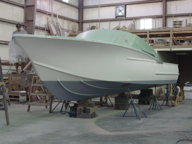

    I'm sorry to hear of the poor TD service, in our neck of the woods it's the opposite but things change all the time. The newbuild is a 37' express slated to get the TD EJS and soon to be announced CAT V-8 diesels. ZF's version is called JMS (Joystick Management System) and utilizes most of the components in their Zeus pod drive system.
    I think the market would be receptive to a 50' convertible pod drive boat and the ZF/CAT combo using C-18's is released which would more than adequately power a boat that size. The main obstacle I think you'll encounter is trying to fit those engines under a pit deck that's proportional and fishable, the only solution I've found is to tuck them under a mezzanine but access then becomes more difficult. You could then gain some of what used to be the forward end of the E.R. but headroom will be a little lacking. To bad they don't make a slanted or flat 6!
    If Carl doesn't mind, here's a pic of that 37;
