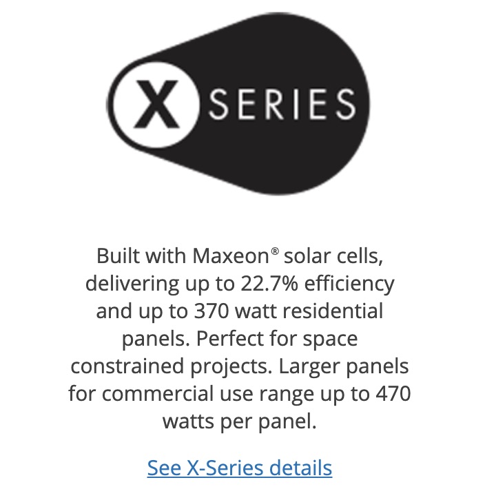

    As I come from a slightly different sector, I'm quite abreast of technology and this particular vessel is using SolarPower Solar Panels X-Series. These are the highest rated panels available today both in terms of longevity and energy production. I have the same series installed on a home I recently sold. There's also a massive bank of LIPO batteries and an onboard generator for lower sun days. I've made an appointment to see for myself this year what the deal is with these crafts.

    That's not as simple as you've stated. There are a plethora of solutions. SunPower offers 4 different models all of which generate different levels of energy. But here's something to think about as an example. SunPower X series panels (as such are the type that are installed on Silent Yachts). They're rated at 370-watts per panel. I can include a link but dare not be in violation of any format rules. Instead, I'll put a simple calculation on some lower quality panels (Not SunPower) as a general example for the math. The Silent Yacht has 25 SunPower X series Panels installed and the battery bank I'd be looking to have installed will store 286kwh. Travelling at 5 to 8 knots, that's quite some range one could get. Drawing on battery banks harder at max speeds would of course deplete the batteries much quicker but.... there's an onboard generator that can recharge the banks to full in (I'm told) approximately 2.x hours of runtime. All remains to be seen.
    If your energy requirements were as such as the average mentioned above (7 Kw) and you were to use 200-watt solar panels, then you'd need more or less 35 panels to take your home off-grid. Or if you used 350-watt solar panels, you'd need 20 panels.
    To give you an idea of how much area say 35 solar panels will take up, you will need to find the total square footage.
    In the U.S, the average homes roof is about 1700 square feet

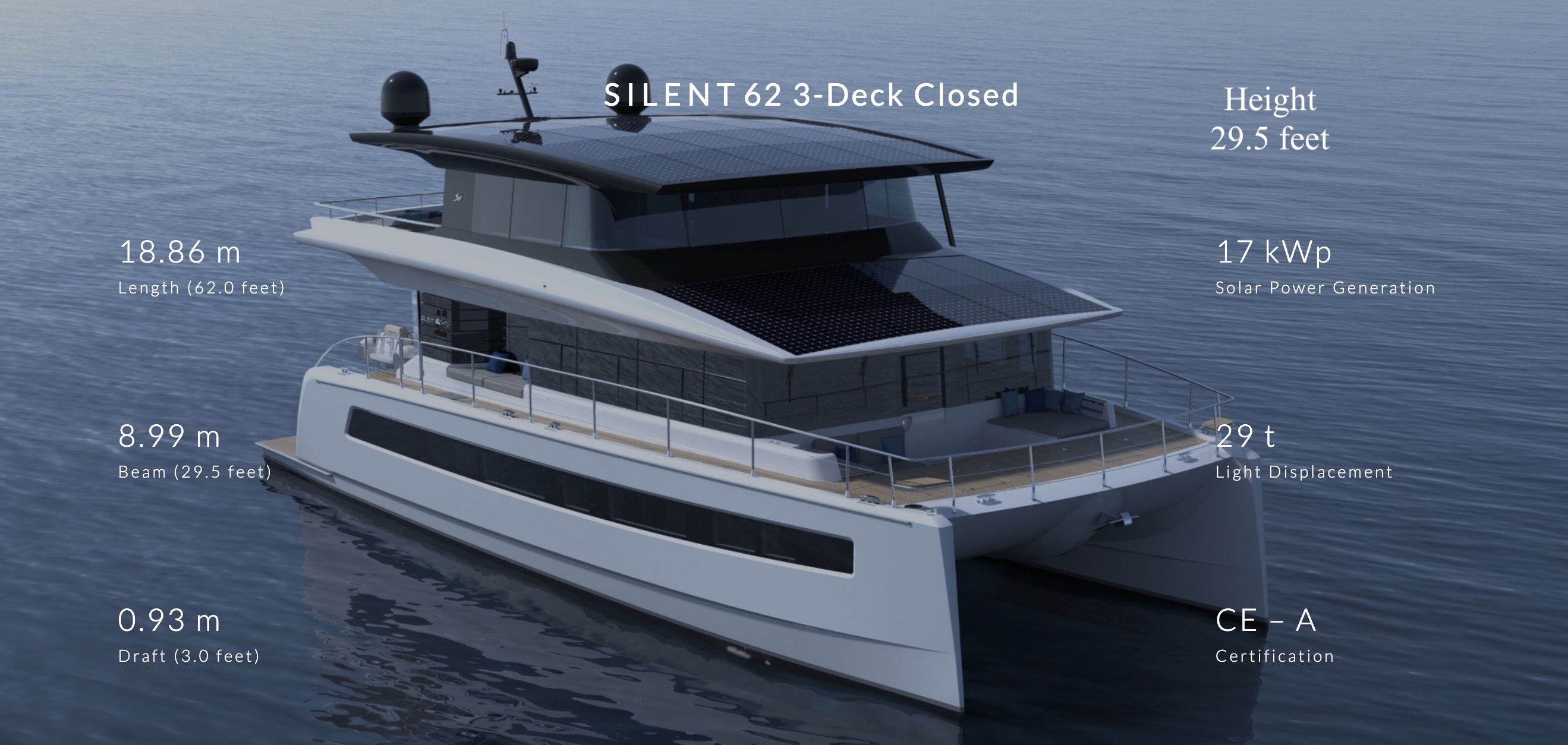

    This model has 350Panels on it at 350watts each. (You can actually count them in the photo) That's more power than I'd given in the previous example. For the record, I do not represent either of these product manufacturers. I am a consumer, a hobbyist, a consumer and one who's looking to do some very creative things in my upcoming retirement with Yachts. I plan to purchase a couple and live the life. Nothing more and nothing less.
    I'm not here to argue or disagree with anyone, I'm just sharing the information I have and attempting to elicit opinions. Many here do not think this is possible. "Just On Paper", as an engineer, the math to me works and for that reason I'm very intrigued.

    A 370 Watt Panel will produce between 1.4 and 1.9kwh's daily (8 hour day). To be conservative, I'll use the 1.4 number. 1.4 x 30 42kwh daily to recharge the lithium battery bank. The X series panels are 61.3"s x 41.2"s. that makes each panel 5.1' x 3.4'. That's smaller than conventional panels and produces a lot more power.

    The 8 hours of full sun sounds great on paper but in the real world for max efficiency the sum needs to hit the panels at a decent angle. Right now in the Bahamas with sunset at 5:30 you ll be lucky to get 5 hours of decent charge rate.
    30 5x3 panels will amount to 450/500 sq feet. I don’t know where you can put that on medium size boat
    just looking at the picture of that cat, the forward section of panels is in the shade from the roof overhang... now imagine that you are anchored to with a N wind. Do you really thing these panels facing north are going to produce a good output?
    now even if you could get that 42kw in your batteries everyday, it still won’t be enough to power all the stuff on board for 24 hours a day unless you forego air con, water making and a bunch of other essentials
