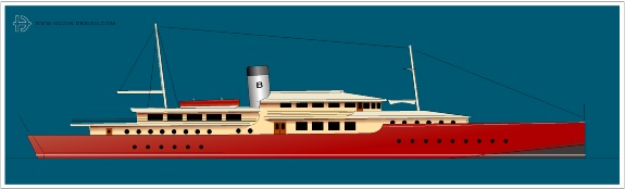

    First, thank you for the kind words on my designs. As a designer I should not comment on what my fellow designers are doing, but as with everything, there will always be room and need for a change.
    The propulsion issue on motor yachts will probably be of increased importance as diesel fuel is becoming more rare and expensive to get.
    I can see other systems where power is generated for electric propulsion and we might get more easy driven hulls like cats or why not narrow beam classic hulls.
    They can be futuristic in their styling or more nostalgic. I started to draw on the latter a couple of years ago and here are the conceptual lines for a 60 meter gentlemans yacht. I know other designers like Martin Francis have more futuristic ideas on the same theme.
    /Lars

    I agree with your comments about Lars Modin's designs. One of the reasons that we've featured his work on YachtForums is because his designs deserve recognition.
    However, attractive or unique aesthetic designs alone do not necessarily make for sensible and practical yachts. The General Arrangements that Lars has included with his renderings are what make his designs compelling. They are well thought-out, based on his own hands-on experience as a broker, a captain and ultimately... a yacht designer.
