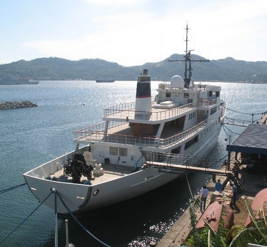

    It seems that converting older and old vessels into 'yachts' or at least that has yacht styling is quite a popular thing to do. We have seen many successful conversions over the years such as the Bart Roberts, Wega and so on. For the most part they people in charge of the conversions do quite a good job. One of the Latest i have seen is this converted tug. Her name is the M/Y Ariete Primo. She is 45M long and 9.5M wide, built in 1967 and refitted/converted 2006. She has a cruising range of 4000 NM.
    For more information refer to... http://www.fraseryachts.com/Charter/Yacht.aspx?ID=Y8976_MC

    Another conversion project is the "Delta Bravo One". She was once an hydrographic vessel for the USSR but now she has been redone and is on sale awaiting an owner to buy her. They are asking 11 million for the 'yacht'.
