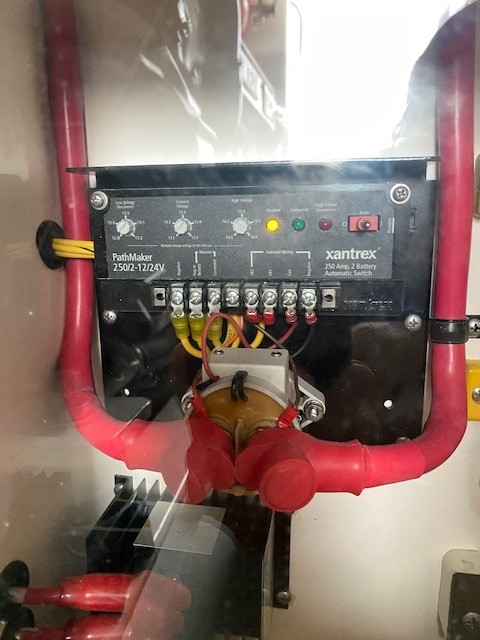

    Xantrex PathMaker.jpg I'm new to these Xantrex PathMaker automatic battery switches. I was reading up on these units recently regarding the factory settings.
    Does anyone know what Cabo originally set the following three settings from the factory.
    Low Voltage Disconnect = 12.8 currently set
    Connect Voltage = 13.1 currently set
    Hight Voltage = 16 currently set

    I luved these things. Sadly no longer made.
    The mini adjustments are a bit crude.
    When I installed these thingies, The dials were usually in mid position, That is where I would leave them, all in mid travel position.
    In your picture, under the combiner is a diode isolator.
    If this is involved with your combiner, you may have to include it's voltage drop in your dial adjustments.
    Without a schematic, I'm purely guessing.
    If this is factory, Maybe Hatt support can answer or at least offer some theory..

    I'm still working to understand the settings on this combiner. Last weekend we went out and anchored for a the afternoon. It was nice so no generator needed for A/C and such. Anyhow, when it was time to go I had no power to start the engines and the combiner had switched off all power, red LED "High Voltage Disconnect" was illuminated. I turned on the engine room blowers and the combiner switched back to green "Connected" and magic my 24 volt DC bus was powered and the engines cranked over no problem. Plenty of available power from my battery bank. I cannot find a tech manual onboard and am searching so that I can read up on the functions of a Xantrex combiner to ensure the parameters are set properly for this vessel.

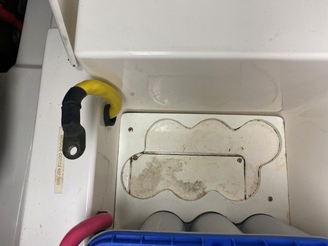

    What is strange is the previous owner changed out all on 10/21 but left one of the start batteries which is the one I just swapped out. This is the first boat I have had with these Optima batteries. My previous Cabo had the LifeLine 8D's. This Cabo is set up with (4) Optima house batteries and (2) Optima engine start batteries. The battery box is built for these batteries with the round coils. They are group 31 batteries and this particular battery was (5) years old.

    For now due to the battery box configuration, I am going to remain with the Optima AGM's. Optima batter box - Cabo 40.jpg

    If you don't want to use Optimas you could just remove the insert via the phillips screws and install standard batteries. I Insstalled AGM group 31's on my last 40 from WM.
