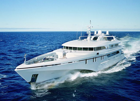

  10. YachtForums
    20,694
    You've raised a good question. White Rabbit is not a wave-piercer, but the narrow cross section of the forward center hull raises some questions. You could say White Rabbit is a "wave-piercer" by the definition of the word, not the actual hull design.
    Lady Lola (seen in the picture below) is a conventional mono-hull. Here she is seen encountering large swells. White Rabbit will not have the same forward bouyancy of a traditional mono-hull. It will have a tendency to "pierce" the wave, as opposed to going over it.
    This is only conjecture, because I haven't been onboard anything like White Rabbit, especially in big seas, but theoretically... this would be my concern.
  11. Kevin
    3,100
    That pic was on the ladylolaandshadow.com website... awesome shot really. Although I think it's a little more to do with angles and perspective than that yacht actually submarining.

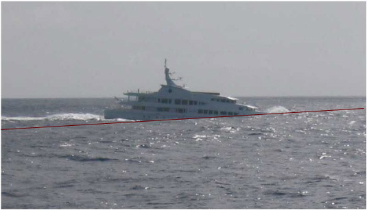

  12. brian eiland
    brian eiland Senior Member
    Jul 28, 2004
    2,979
    St Augustine, Fl and Thailand
    Ocean Swell, Bow Down
    That is an interesting photo. I can't seem to pick out that large of a swell??

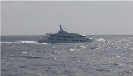

  13. JonS
    JonS Senior Member
    Feb 7, 2005
    362
    Here you go Brian. I thought that picture on the other website was not particularly clear either, so here is my version.... hope this helps.
  14. JonS
    JonS Senior Member
    Feb 7, 2005
    362
    Looking at the two photos together, it seems to look like a pot hole in the water! :confused:
    But if you follow the direction of the swell it does make a little more sense!

  16. YachtForums
    20,694
  17. YachtForums
    20,694
    Congrats Jon!
    Quite the optical illusion on that Lady Lola swell, heh? The pitching of a hull in rolling swells will only magnify the problem we're discussing, as we can see in the down angle of Lady Lola's hull in these pics. With White Rabbit, this pitching should be reduced over a conventional monohull, BUT... if a trimaran was to encounter a specific set of wave frequencies, it could have a different outcome. Hard to say, but interesting to discuss. :)

  19. JonS
    JonS Senior Member
    Feb 7, 2005
    362
    Yeah, I recon the photo is taken at an angle of the port side of the boat which is facing bow end into the swells. Therefore as the photo is not straight, the swell appears incorrect as we do not see the position the photo is taken.
    Would that be an appropriate assumption?
  20. YachtForums
    20,694
    I've been offshore in big swells, running along the side of other yachts in the 100'+ range and I've seen the dips firsthand, both on our boat and theirs. In the Lady Lola picture above, the swell in the foreground is basically hiding the bow, BUT... she IS at a bow negative angle in relation to the horizon. Also notice the release of displaced water to her stern.
    It appears to me she was coming off the back side of a swell and the following swell was about to give lift to the bow... just before this picture was taken. The spray off the bow in this picture shows she was beginning to displace the oncoming wave.
    This picture is not unusual in offshore conditions, but the angle taken (from the backside of the swell in the foreground)... IS unusual. You can't believe how BIG it gets offshore. Sometimes a superyacht doesn't feel big enough! Because rogue waves happen... you will sometimes see the forward and/or bridge windows "boarded" up. Usually it's with custom fabricated aluminum plates, but I've actually seen plywood used for this.
