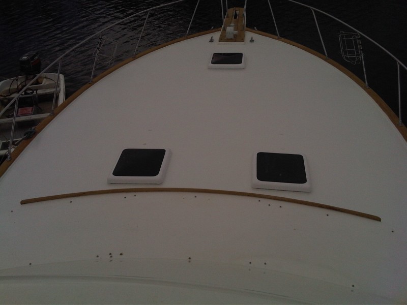

    I have a 1988 46 Post with Awlgrip "Oyster White" real nice finish on the forward deck. I will be repainting the transom this spring due to Hurricane damage last year. Also I need to recoat the forward deck and the non skid areas. I will post some pics when we get to it in the spring. Also any info on painting the forward deck non skid areas would be appreciated. I watched a few You Tubes on it, I think I have it, but couldn't hurt to hear from you guy's.
