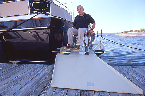

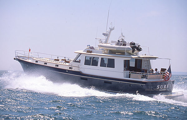

    This may be out of your size range, and/or budget, but I think that New England Boatworks and C. Raymond Hunt and Associates did a fine job with this one:
    http://www.neboatworks.com/surf.htm
    If you want a boat that can go to sea, you can't beat the Hunt hull.
