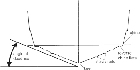

    I've been researching a lot of the details on the boats, and one of the things I have come across is Deadrise at Transom, and I have googled this as well, but it is not really making a lot of sense to me at the moment.
    How do I, or should I even be, comparing the Deadrise at Transom for the boats that I am looking at. I am not looking at doing any trans-atlantic, just cruising the great lakes and the Eastern Seaboard.

    The amount of V shape in the bottom of a hull is known as deadrise. Technically, deadrise is an angle measured upward from a horizontal plane at keel level.

    It sounds like, from the boating article, that Deadrise is rather subjective in terms of how a boat will really perform. And that your sea trial(s) will make the true determination of what you will and won't tolerate on the water...

    Hull design has been a balance of compromise near forever. The flatter the hull, faster and cheaper to run but your teeth will fall out. V hulls have more wetted area (friction), weigh more and require more h p to get enough of the hull out of the water to act like a planing hull. Yes, lifting strakes, chines, mod Vs, pads and lots more tricks added help in some areas and take off in others. Healthy teeth love V hulls.
    Local use also dictates hull design, shallow, lots of flair, interior volume for da wife & in-law. Fishing inshore, offshore, bad inlets, required range.
    There are hundreds of boat manufacturers out there, hundreds plus of hull designs.

    Also to consider that deep V will roll more both at anchor and cruising.

    I've found that deadrise is something a lot of guys like to mention to make it sound like they know about boats (especially salesmen). Same with engine stats. Most learn a few numbers for certain engines and always try to turn the conversation to that engine so they can sound knowledgeable. As mentioned earlier, deadrise is only one number in a formula that helps a boat run a particular way (fast, economical, less roll, etc.) Fortunately we do have some people here who actually understand about how to design a boat or yacht, but for the most part you're right on target. Sea-trial. Put a boat through it's paces and see if it satisfies your needs. Then, when you buy it and talk to you friends, slip into the conversation that it has a 17* deadrise at the transom to impress them with your knowledge.:D
    If you ever decide to become a naval architect then learn all the factors that make a boat perform a certain way. (deadrise at the bow in relation to deadrise at the stern, chines, steps, weight distribution, power, propping, and on and on. Till then just enjoy the ride.
