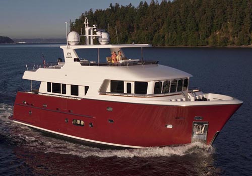

    In our recent review of the Horizon EP69, we stated that although this boat has motoryacht and trawler-like features, it doesn't qualify as an Expedition, which is the designation that Horizon has given the vessel. I usually quantify an expedition yacht based on signature design attributes, but also range, stowage and a certain utilitarian prowess.
    With it's big freeboard, displacement hull coupled with a Portuguese bridge and forward swept pilothouse windows, the EP69 is very trawler-like. Horizon didn't want the boat "pigeon-holed" in the trawler category. Instead, they want it viewed as an alternative to someone seeking an Expedition yacht. For me, an Expedition must have serious range and the EP69's reach is more like a motoryacht. Horizon wants it known that fuel capacity can be added, but does this make it an Expedition? If anything, it's a hybrid; difficult to categorize.

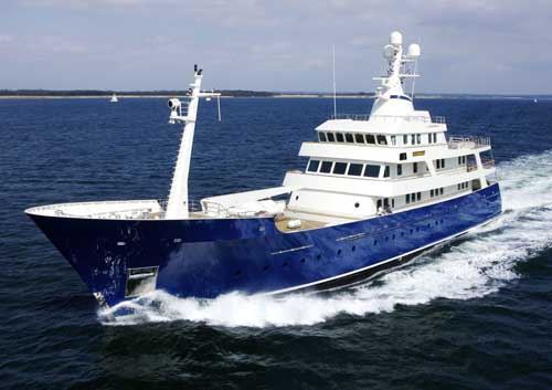

    What are your thoughts? What defines an Expedition Yacht? Below is a pic of the EP69 and the quintessential expedition, Turmoil.

    These are all words that an Expedition yacht should bring to mind. A boat that can go through any weather. This is not to say it should look like a rusty Tug that's been sat up a river for 20 years or that it's been hit with the ugly stick.
    I looked at that Horizon and thought where could you explore with that? Pulling alongside of a rough fuel dock and taking on low quality fuel, what systems are in place for fuel treatment, let alone fending off uneven concrete docks without stout rubrails. Food storage, as Judy pointed out, and a galley layout that would be a world of pain for cooking at sea. All these little things make a proper yacht a sea-going yacht, not a marina prima donna or a weekender.

    I don't think that kitchen could stand up to 10 days of haute cuisine, but you could probably manage 10 days of something you would call food for 6-8 adults. It looks like the Nordhavn 72' has the same cold provisioning capacity, probably more dry provisioning space though.

    I see an Expedition yacht that can travel on it's own for 3 months at a time (not necessarily moving every single day), but one that has a 3,000nm range, enough food storage for 3 months, spare parts and dry food storage, very well built and something that can take 20' seas if it has to.....A 80' Northern Marine...Nordhavn....or many others fit that bill......
