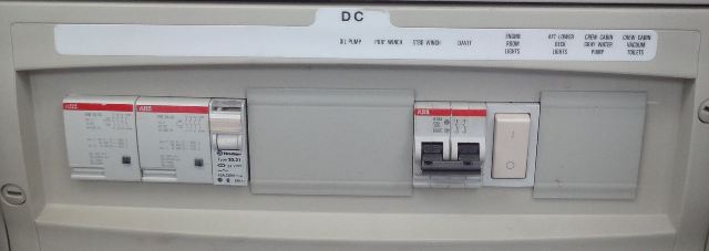

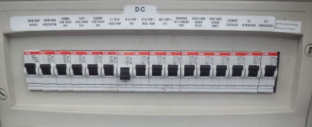

    I had a shorepower cord fry on my Azimut 55. It was during a significant rain storm, and I suspected the problem was attributable to a poor connection at the dock. My wife made the connection, so I blamed her. Maybe I should have blamed Azimut?
    While I owned my 2005 Azimut 55, aside from the fried cord, I don't recall any major electrical issues. However, it was obvious to me that the wiring installation was not done with a high degree of professionalism.
    Below are some photos: (Note: the resolution isn't high enough to read the labels, but I think you'll get the idea)
    Notice how the panel labels don't align with the breakers below them? Also, while there is a breaker that is labeled "Hydraulic Gangway", I didn't have a hydraulic gangway. I never did figure out if that breaker serviced anything.
    Notice the switch in the lower panel. That's the light switch for the engine room. The panel is IN the engine room, so you need a flashlight to find/open the panel, so you can turn on the engine room light. Honest.
    If you were to look inside these panels, you'd see a rats nest of wires, most of which have cheap looking connectors. It would not surprise me if there were problems that I didn't/couldn't recognize, such as undersized wiring or breakers.
    On my current boat, the wires are all well tied, well connected, and most actually have labels. I'll bet an electrician would rather trouble shoot an electrical problem on my current boat, if for no other reason than he can get to the panels without a flashlight.
    Again, other than the fried shorepower cord, I never had any major electrical issues. I enjoyed the boat as it was wired. However, the lack of attention to detail is apparent, and that may have made a difference to me at some point.

    These breakers look like standard off the shelf, European home style breakers. I wonder if they are or if they are marine breakers that just look the same.
    One look behind an electrical panel usually tells the story about the boat quality. If you find a rat nest of unmarked or not numbered wire... RUN!
    A fried shore power cord is rarely caused by the boat, unless the builder cheaped out and used un tinned wire
