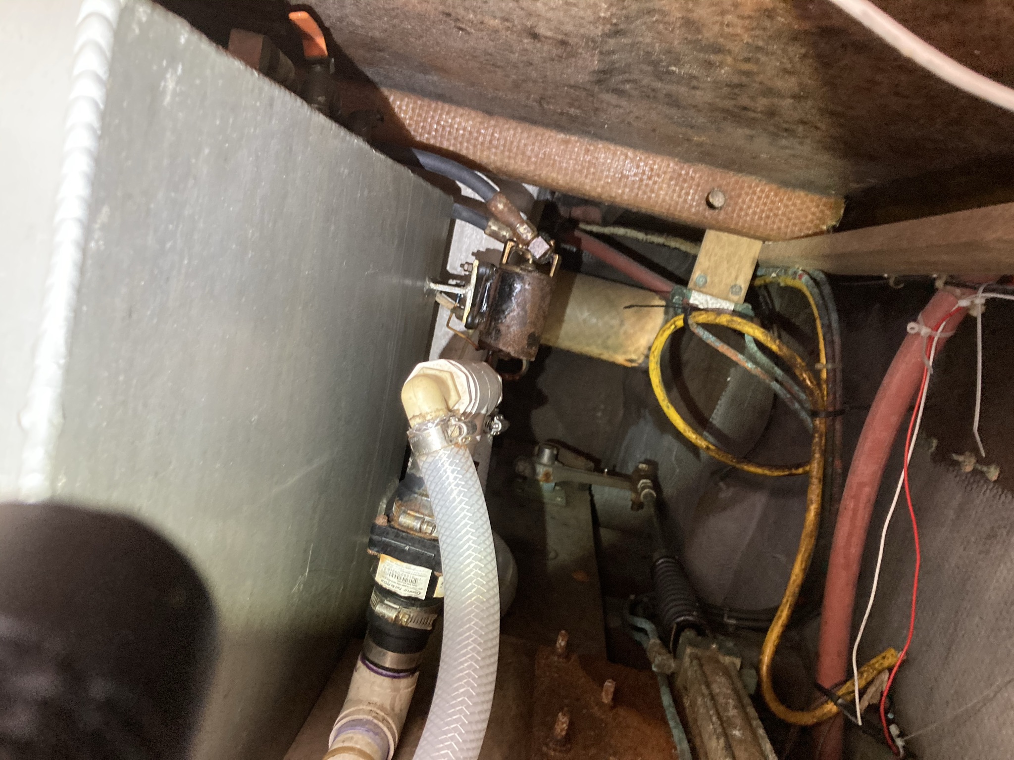

    For the first time yesterday, I was getting low flow from my faucets with lots of air. However, I discovered my starboard tank was empty. Filling it up from the Starboard side fill, cured my issue. Sucking air from an empty tank I suppose. I just always filled from my ports side. The tank gauge read at least a half tank.
    I assumed that you could fill both tanks from EITHER side and water would flow into both. Is this not the case? I see the plumbing between both tanks and the port tank is the one with the sending unit.
    The manual states that water my be added by either fill-port but doesn't state that each tank must be fill by their respective fill ports, to fill both. I assumed that these fill-ports were just a matter of convenience, port or starboard. I though maybe I had a vent issue on my starboard tank not allowing the filling of water to starboard tank, if I filled from the port side.
    What am I missing here...what is correct filling procedure?
    Thanks.

    Thanks Greg. Yes, mine is the same. I will try filling up port side with water next time, with the starboard fill cap open. If it fills, then perhaps I do have a clogged vent on that side.

    I have always had to fill on each side.
    There is a check valve between the tanks on mine.
    1980 -46.
    My plumbing is forward of the aft fuel tank too, I can get at it from the engine area.
    Looks like yours is aft of the tank. Looks much more difficult to access.

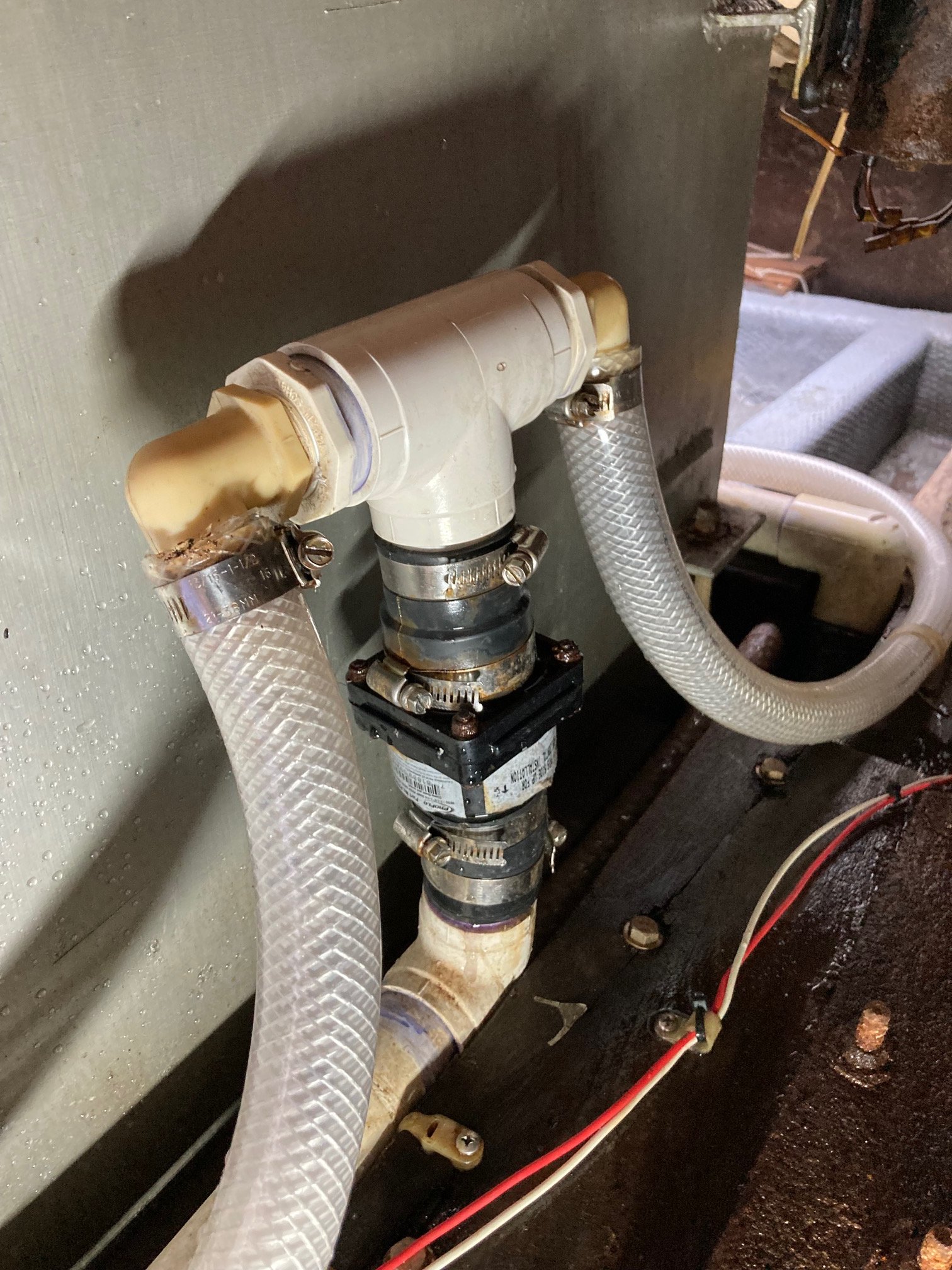

    I did an experiment filling the water tanks today. I can fill both tanks from one side if I fill them slowly. If I fill with the hose on full, which ever side I fill will overflow first. I can watch the gauge balancing the tanks (gauge goeing up if fill stbd first etc). At full hose flow both tanks will accept toping off after they balance themselves.

    More on the tank filling mystery resolved. The tanks will not begin to cross fill until the one being fed reaches at least half full. That is when the water can cross flow throough the T shown. The check valve below the T, once primed, prevents water from draining back to the tank(s) through the hoses running to each tank bottom when the tank level drops below half. If/when the check valve dies (as mine just did) the water pump will not prime or stay primed.
    I have no idea why they didn't just connect the hoses running from the bottom of each tank to a T at the level of the tank bottoms instead of going the check valve route.

    91-46. Mine is a little different. I have one fill cap in the cockpit For both tanks. No check valves in the fillside just the T to both tanks and no check valve in the drain sides at the bottom. Both tanks fill until until port tank is full then starboard tank tops off, then overflow comes out the port vent in the cockpit. Everything worked great until the gasket on the sensor in the port tank started to disintegrate and leak water out the top of the tank and into the bilge. Had to pull the sensor and replace the gasket and the assembly. Very very difficult. It is on the forward side of the port tank towards the engine room. It is only accessible in the dark and with one hand. 5 screws not spaced symmetrically plus the gasket holes and the holes in the top of the tank all need to be lined up of course. It took me lots of hours to reach my arm in up to my shoulder while curled up in the engine room strainer area. But it works great again. overflows to the cockpit when both tanks are filled.
