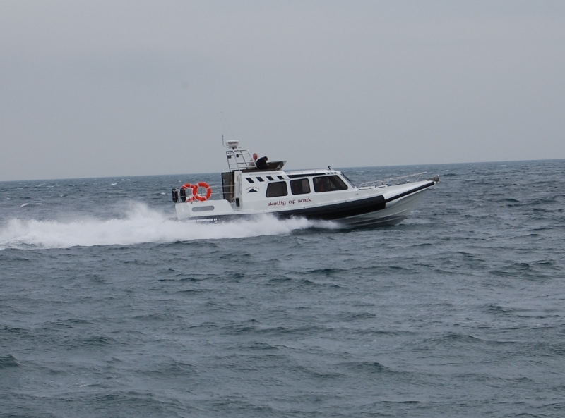

    Heck mate, got one one these for sale and one side goes a bit soft.
