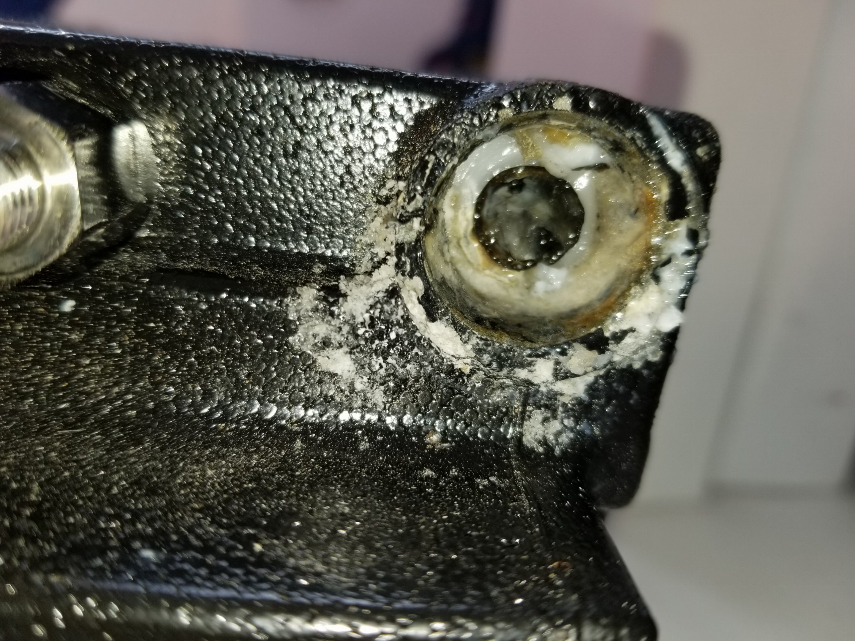

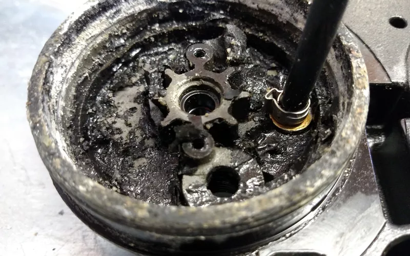

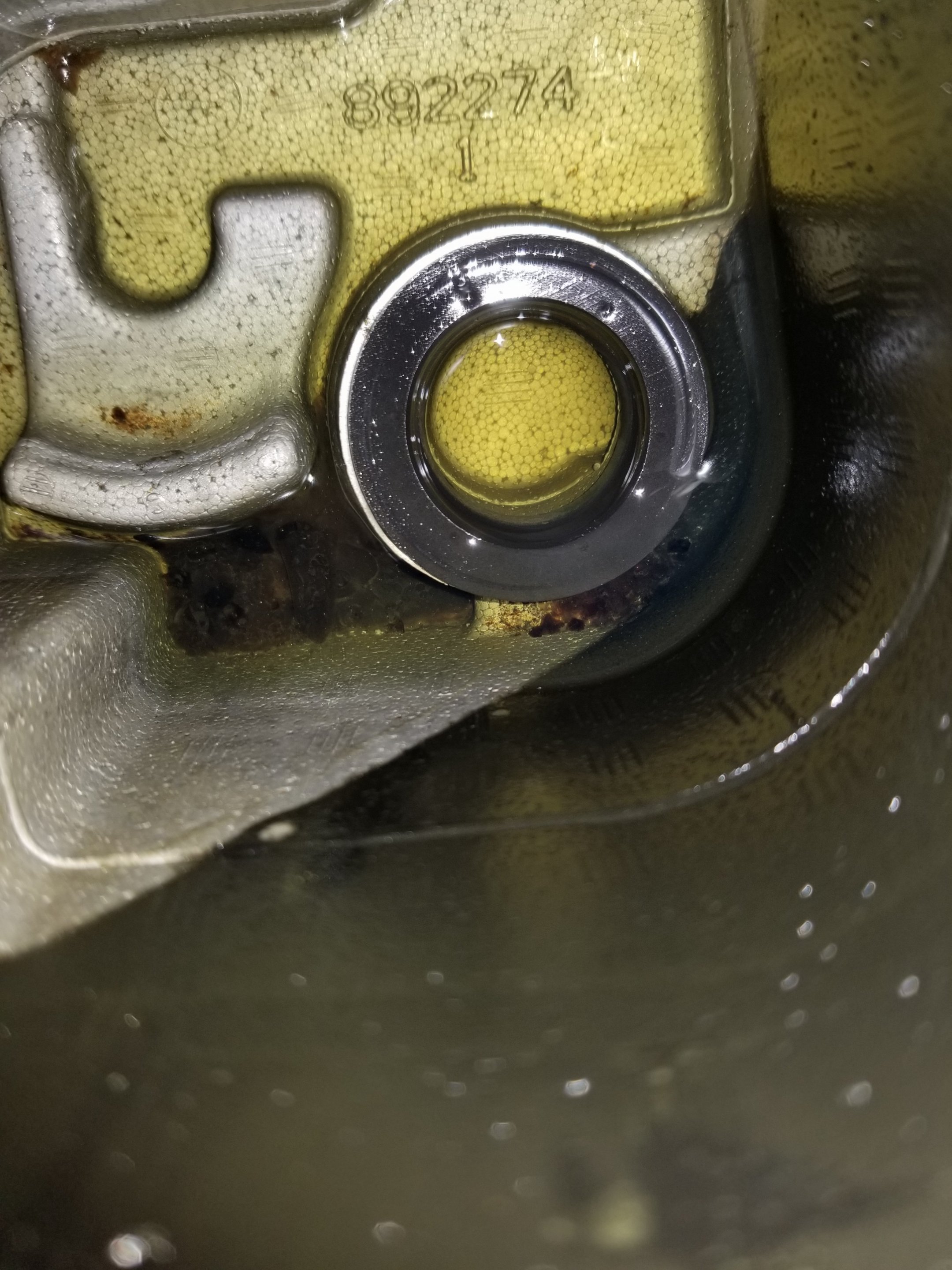

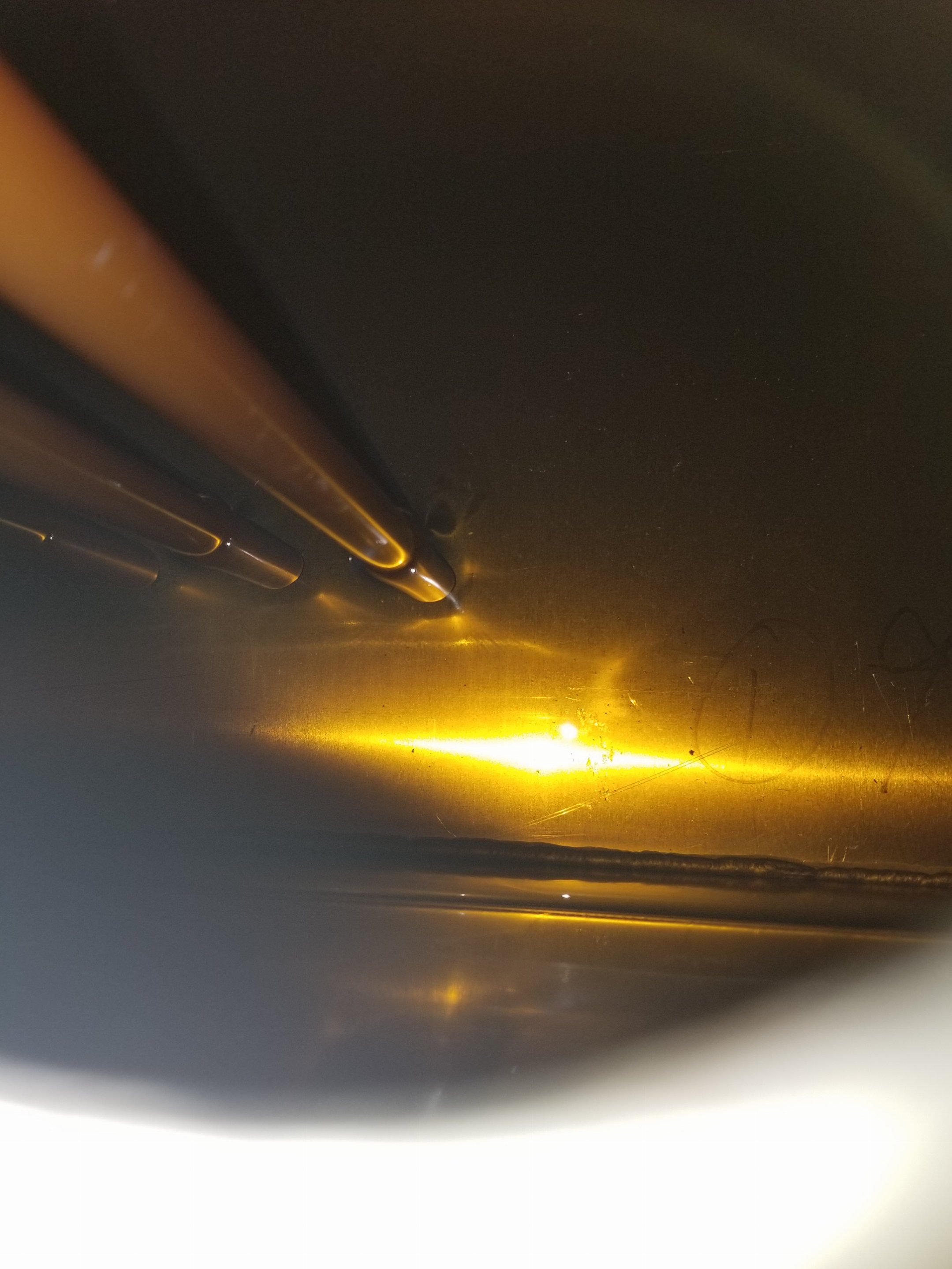

  9. Capt Ralph
    12,647
    10 year old gas tank is clean. you can still see hand written notes on the bottom.
    Broken fitting and water passage clogged.
    Goo in chamber bottom.
