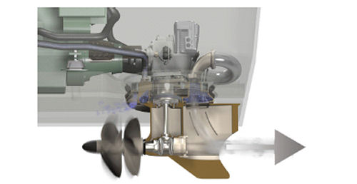

    I sea trialed a Cruisers 390 Sport Coupe with VP 550G IPS system - at idle/near idle speed - there was a very noticeable vibration - dealer suggested it was air bubbles from exhaust on the hull... seemed like they were some pretty big bubbles :)
    Just above idle - vibration was completely gone...

    The Volvo IPS systems vents the exhaust through the drive units themselves, much like a stern drive. Depending on the year of the boat / drives, this is perfectly normal for the IPS drives to be bubbling and causing some vibration on the hull while sitting at the dock / engines running.

    Depending on how much is hanging over the stern, you will get a bit of bubbling from aft.

    I assume this happens just when the boat is running in the slip as well? If thats the case, this is normal. Our IPS500 powered Tiara shudders (for lack of better term) while idling in the slip due to the exhaust exiting under the hull. If there is a lot of vibration or it changes while underway I may be a little concerned.

    You are spot-on - at idle it "rumbles" or as you state "shudders"... as soon as you throttle up even slightly it disappears...
    I am feeling better that this is normal - and not my overly pessimistic side coming out :)

    Maxwell hit it spot on the head, I had heard that Volvo was going to install a "dump valve" on the exhaust system, much like Cummins Zeus drives have (they divert exhaust over the side, above the waterline at idle, and then at about 1200RPM is goes through the hub and out through the wakeline.
