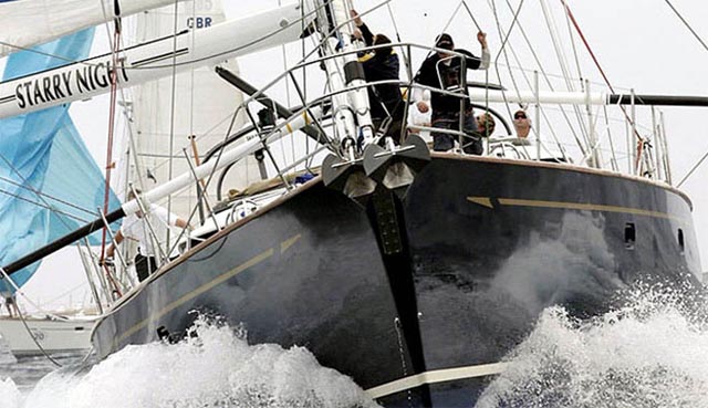

    Starry Night is reported as an Oyster 86.
    Starry Night - Wild Vinyl Boat Wraps
