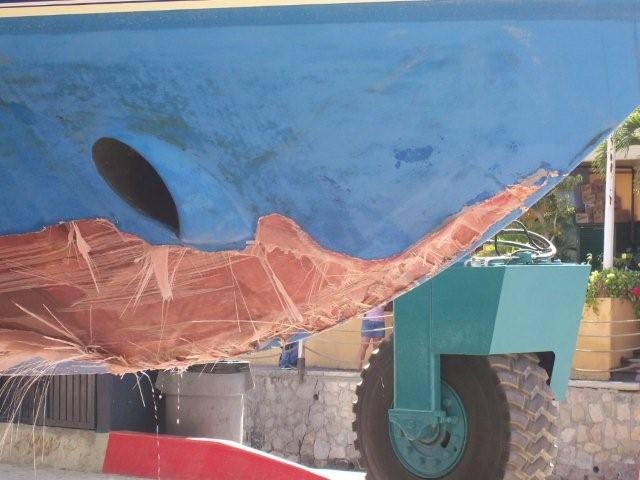

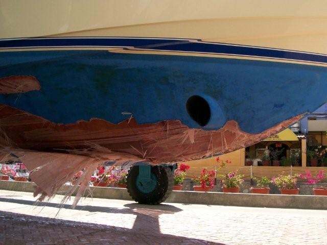

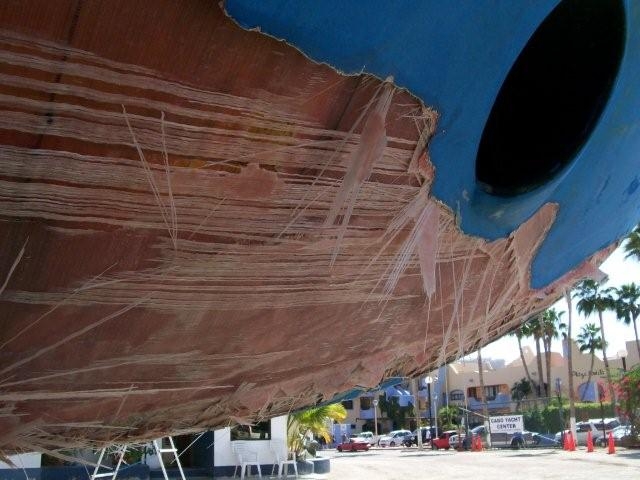

    I just saw some photos of the Bad Company. They hit a whale the other day and destroyed the bow of the boat. Anyone else seen these photos?

    Pics.............

    Not a good day for Team Bad Co... I feel like a kid with his bike stolen, sick to my stomach. Below are emails from Steve... Pat Healy from Viking said in all his years building boats, he has never seen an impact this major isolated to the front of the boat...
    But it's just a boat, everyone is safe and that's all that matters..

    Seems a whale of a tail to me. I see some evidence of delam! Looks all too familiar, maybe the 630 Bert also hit a Whale, yes!

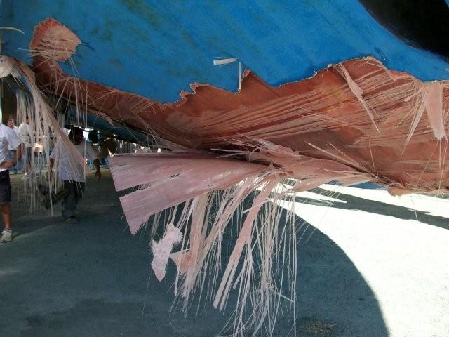

    I would not doubt the story is accurate but i can't help thinking that a solid glass bottom would have faired much better. some cracks, some water in but not the massive amount of delamination we see here.

    The delam occurred after the impact with the water tearing strips of fiberglass free as they made their way to port. I think it's lucky they all survived the crash and a good example of how tough Vikings are built.
  8. Pascal
    8,165

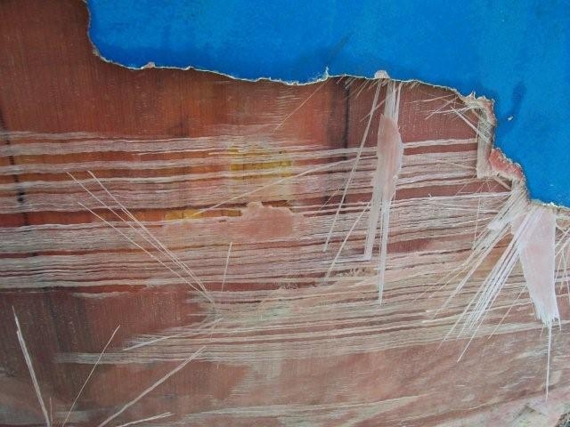

    I understand that, but doesn't it show that no matter how well a cored laminate is built it will fail even more dramatically once something happens?
    I don't' think a cracked solid glass laminate will be ripped and pealed like this.
    Remember that coring is not used for strength, it is used to reduce weight while keeping the laminate stiff.

    I think that you would see this on any type of fiberglass construction. Even a solid core fiberglass is layered and layered. A crack through the hull and the hydrolic pressure would evenually find a weak point and exploit it. Whether it is solid or cored is irellevant I think. (I however like having two materials. I would prefer the strength comming from juniper planked construction though rather than a balsa core laminate construction.) In this case though I think that the laminate was strong enough to take a 22 knot beating of a breeching whale at 90 degrees and make it back to port safely. Pretty impressive.

    We saw what happend to the boat... but what about the unfortuante whale? Anybody knows what happened to it?

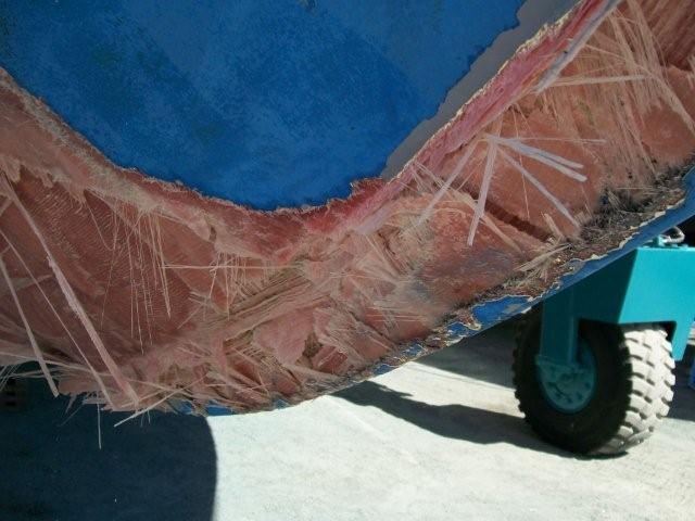

    As for the delamination, certainly the effect shown on the photos is due to the water pressure hitting on the damage area while enroute to land (any reference to the Bertram 630 case would be pure mean specualtion). Nevertheless, i think that a solid "old style" fiberglass hull, even after hitting a floating object that would crack the gelcoat, would never end up revealing the different materail layers used in building... or not?

    Maybe the fact that the whale hit so close to the bow thruster it caused more damage. That could be seen as a weaker spot on the hull. Just a thought.

    It looks like it held up a lot better than that big Bertram with the catastrophic delam. Kudos to Viking, glad everyone is safe.

    I agree. A solid fiberglass hull might get a crack, but I don't think you'd see the peeling like we are with the cored hulls. The solid fiberglass should stay together as it is essentially one unit when laid up and not peel like the cored hulls do.

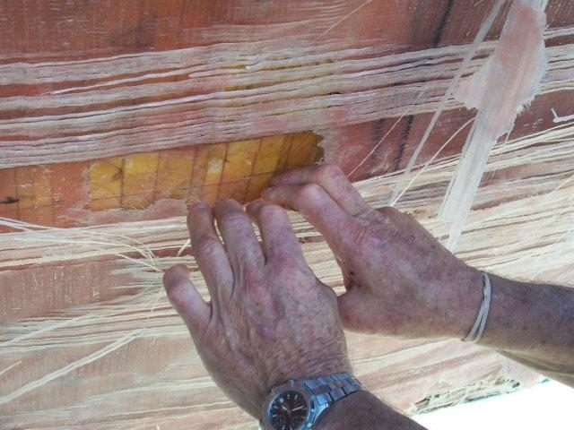

    But the point I really want to make is that after having worked with formula race car laminants for years, cored laminants are in no way comparable to solid laminants, assuming both are done correctly. Yes cored laminiants offer superior stiffness and rigidity, but only for as long as the laminant fully maintains its bond integrity. I have seen so many properly vacuum bagged laminants slowly fail from repeated pounding and stress cycles, that I simply wont own a cored hull. The only coring I have ever seen done properly is vacuum bagged and OVEN baked chasis and suspension components use in F1 or similar chassis. For these to be succesful, solid inserts are used at all heavily loaded or attachment points. I have just seen so many vacuum bagged components delaminate when subjected to endless hours of stress cycles.
