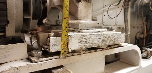

    Engines are 671tib. Need to do an alignment and am a little stumped. The mounts look like they have shims and hard bolted to rails. Any insight?
  2. bayoubud
    bayoubud Senior Member
    Feb 19, 2017
    1,149
    Florida
    Had the same setup on an 89' Viking 45 sf. You just have to remove or add shims to correct the alignment of the couplings, not as easy as cranking adjuster bolts. Takes more time.

    I was taking shims out at the gear to lower the coupling. Used a pry bar to raise the engine at the mounts. The shims are just flat rectangular pieces of metal with different thicknesses. Check your mount bolts to see if they are tight, then check coupling gap to see which way you need to move the engine, you may not need any shims. Pull one if you need shims some have bolt holes or slotted. O'reilly auto parts has a good variety. Good directions on alignment:

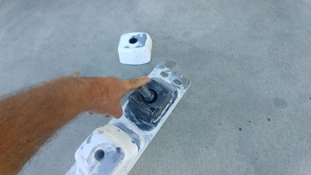

    Don’t know if this helps but here is a picture of a Viking motor mount that I had replaced. It. Had previously been cross threaded (I think). I was surprised when I learned that motor mounts are not as simple as they sound. Different engines require different rubber.

    Dockmaster laid it out. You have work to do before aligning the couplings. Post a picture of your mounts, if your setup is like the 45 Viking I had there are no rubber engine mounts.Engine is bolted hard to the I-Beam bed on shims. If your cutlass bearings are worm badly the shaft may align with the shaft log when replaced. On my 45 the we pulled all the shims on the stb side gear mounts to align the coupling, could not go any lower without modifying the mounts. It was misaligned at the factory or the hull was sagging.

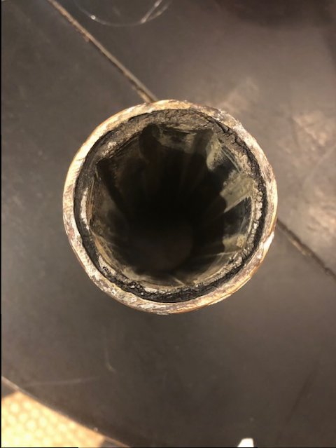

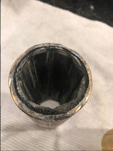

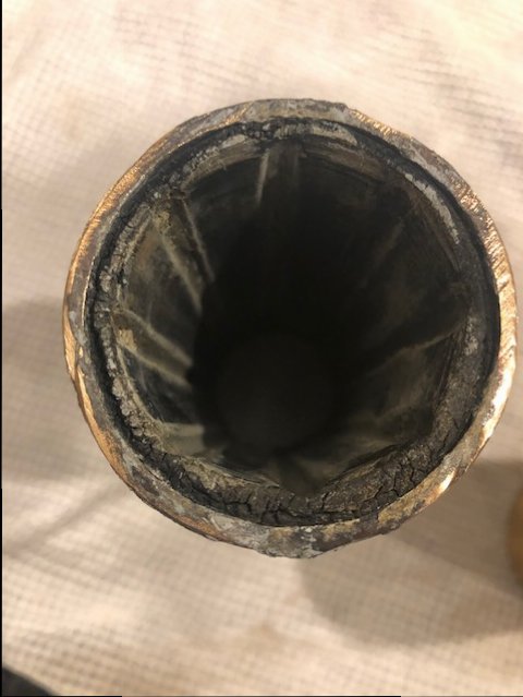

    Cutlass Removed.
  18. DOCKMASTER
    DOCKMASTER Senior Member
    Feb 26, 2012
    1,584
    Ketchikan, Alaska
    Is that the bearing from the shaft log or the strut? Definitely needs replacing. What size shafts do you have? Are you checking the shafts while they are out?
