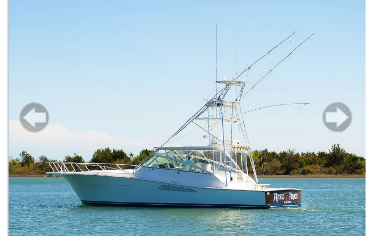

    Just wanted to post up and see how everyone's doing. Hope everyone had a Merry Christmas! Still looking at some boats and still looking at the 50 Vikings. Found a 61 with cats but can't justify 93gph at cruise . So we more less decided on a 50 express . Love the layout and fishability. We will mostly be day fishing with some overnighters and fishing some tournaments. The inside layout is huge for an express and more then suits what we want . Plus the express with the 1050s is quite fast . Hopefully surveying in the next three weeks. I'll keep y'all posted.

    Nice looking boat, good luck with your purchase!
