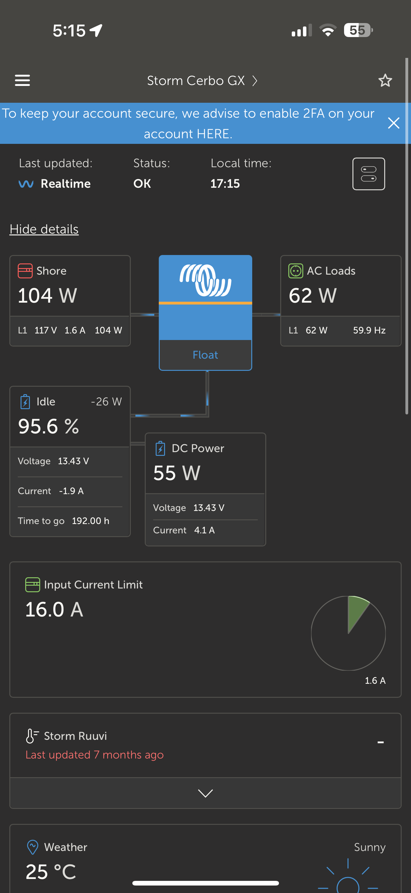

    What are you looking to see? I think you need the inverter and also battery monitor to see everything. I also have a Cerbo GX plus display which allows me to see everything going on from both the display and my phone/computer.

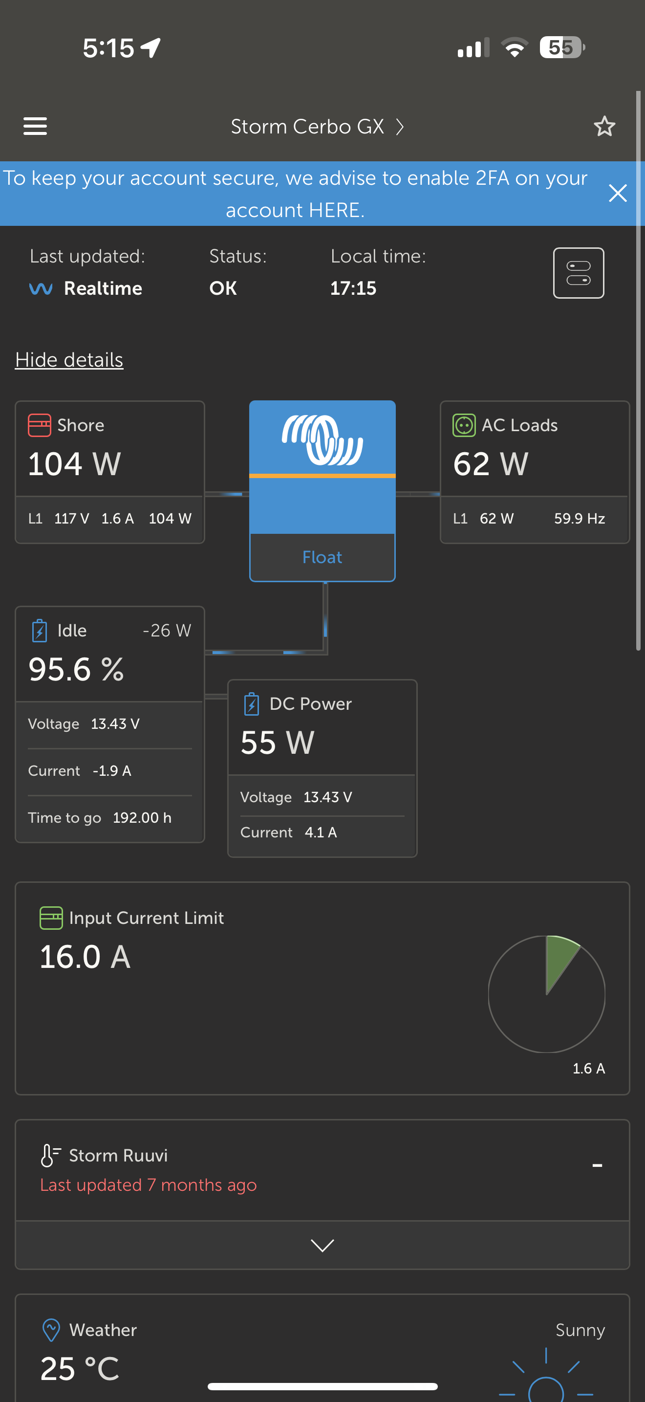

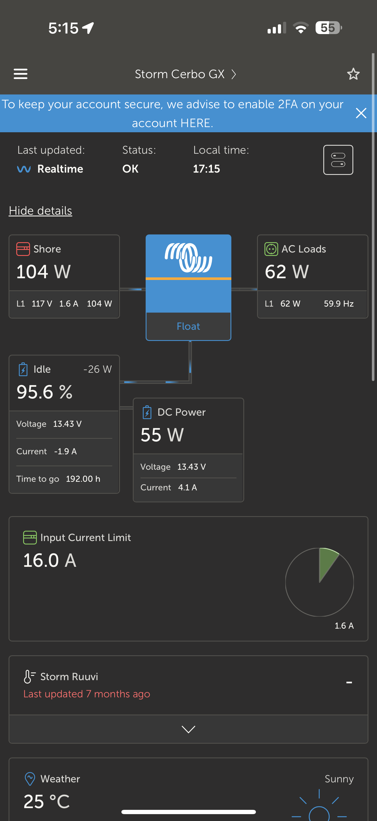

    Here is what I can see in my portal but this is with a multiplex, BMV-712, and CerboGX. I don’t have my tank levels hooked up here but I do have my bilge pumps hooked up so I’ll get notifications if it ever goes off.

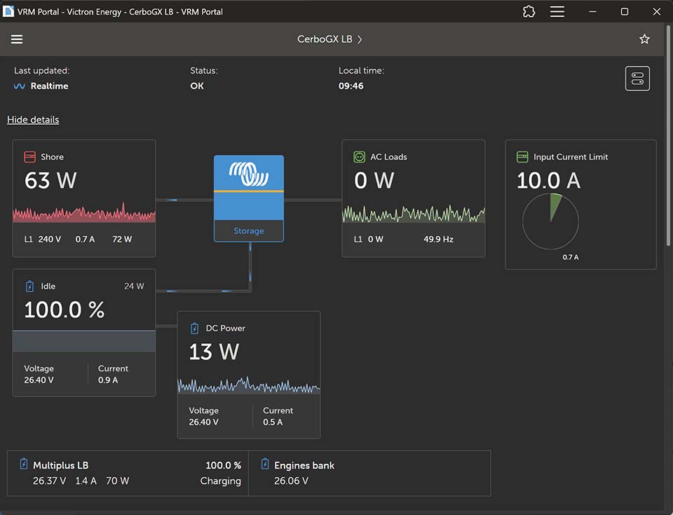

    But recently, I bought a Cerbo GX, mostly for remote access/check when I'm not onboard.
    And i can tell you, it's the best thing since sliced bread: it connects to the onboard wifi (which I already had for onboard cameras), and gives access to each and every functioning parameter, allowing also to change settings, if you wish. Personally, I prefer to not fiddle with electrical parameters while I'm not there to see what happens, but theoretically there's no limit to configuration changes, also remotely.
    On top of all that, the Cerbo GX can work also as a sort of gateway for other units/sensors, like temperature, alarms, tanks level.
    I've only used it for the Multiplus monitoring (so far), so I can't vouch for these extended functionalities, but there's plenty of positive feedbacks on the web also for those.

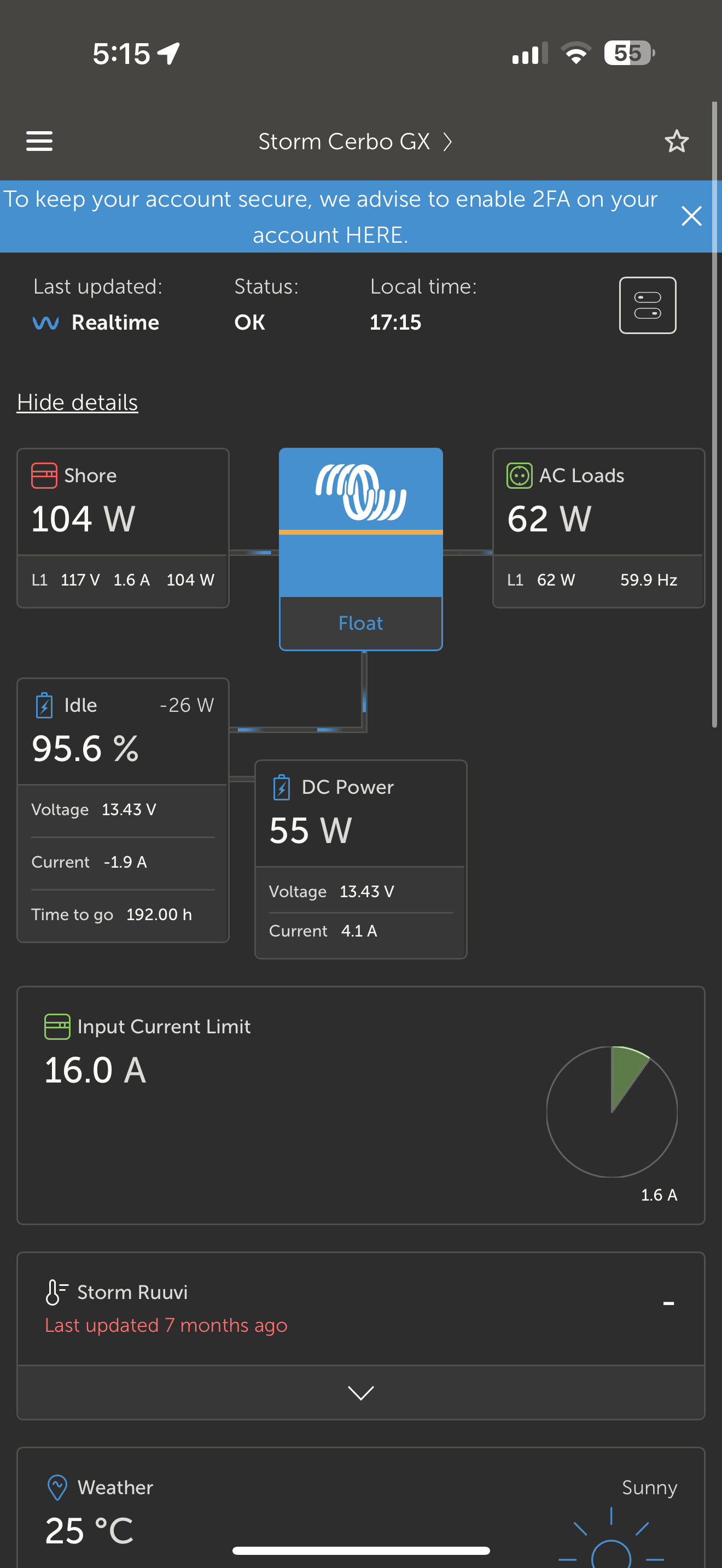

    Just as examples, I'm attaching the VRM (Victron Remote Monitoring) screen I'm now accessing from home, which is similar to the one already posted by GY - BTW, he says he also has a BMV-712, but that's not required, and the Cerbo GX access makes it redundant, sort of.

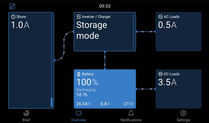

    The other shot below is what Victron call "Remote Console", also accessible via VRM, but mostly designed for onboard control, either with a smartphone/tablet, or one of the dedicated Victron touch screens, available in 5" and 7" size. RC.jpg

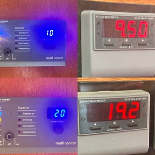

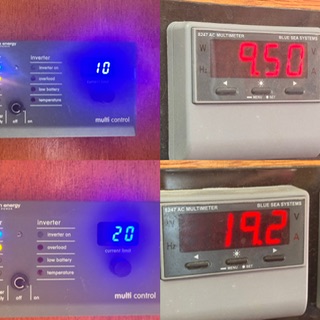

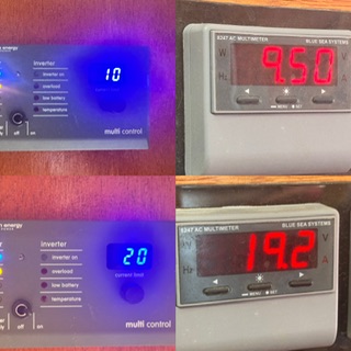

    I don’t think that s accurate at least on my inverter and remote, maybe the US version is different.
    right now we re on shore power at a transient marina on the west coast Florida on our way to Tennessee and juggling all the loads on a single 50amp cord. Watching the digital amp meter on my main panel while adjusting the level on the remote, I can see the amp meter responding. This allows me to reduce the charging rate (I have all night to recharge the inverter bank) so we can have more power for other loads.

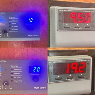

    It only affects the charging rate in bulk mode. I checked again today after we anchored and started the generator. Sure in enough amps shown on the main panel double when the remote dial is turned from 10 to 10

    I suppose you meant from 10 to 20 (or 20 to 10), right?
    Anyhow, the behavior shown in your photos actually confirm that the knob function is to limit AC absorption from the shore connection, if you think about it.
    I mean, your AM-meters on the right are related to AC, not DC.
    So, what happens is that if the Multiplus needs say 20A of AC for bulk charge, by limiting the AC shore to 10A you are actually limiting ALSO the battery recharging, because the Multiplus can't draw as much AC as it needs for DC bulk charge.
    In other words, the reduced DC charging rate is just a consequence of the AC limit chosen with the knob.
