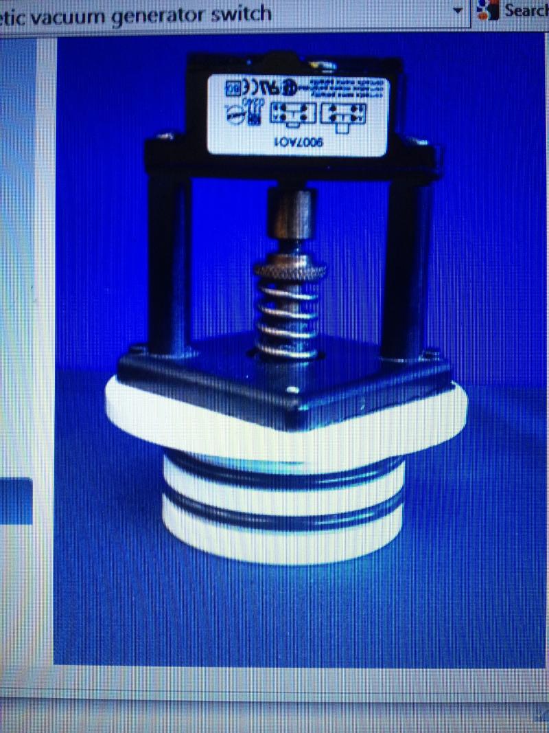

    Pictures of switch
  10. Capt Ralph
    12,740
    Cleaning/replacing the O rings can offer the same results and bux cheaper.
    Before you jump on the switch wagon, the duck bills have been recently (correctly) replaced?
    Two systems? Rotate the switch assembles between the systems and see where the problem goes.

    I've had to replace those switches before and have had them go bad. Given the year of your vessel it's probably about time to change the switch. Try wiggling or tapping the switch a little and see if that causes the pump to come on.
