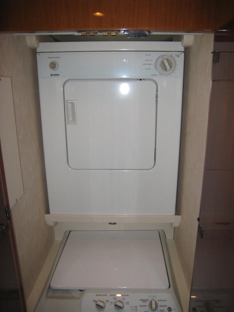

    What's the deal here, the washing machine tub has a large white "travel device" in the tub that I can't remove?? Takes up most of the tub, save a small center insert and an inch or two on the outside. Does this come out? I can't find anything online about its use! Any help would be appreciated

    New washing machines often have an insert to stabilize the drum during transport. Since washing machines on boats often don't get used it could have been left in. I'd expect it to be either a light plastic or Styrofoam cover place over the drum before the lid was installed. It will have to be broken or cut out. HOWEVER, could you post a picture before you do that just to be sure?

    I have a 2000 50' Post. My washing machine has a round insert with two sliders made out of (I think) starboard material. The sliders are held in an open position by a center insert piece held in place with a cotter pin. On my set up, you remove the cotter pin then pull up on the center insert piece. Then you move the two slider pieces in toward the center until they touch. At that point the round insert can be removed and stored. Attached is a picture of the washer and dryer for reference. I didn't have any pics of the insert...

    Post made that insert so the tub stays stable in heavy seas. You didn't provide a picture of it but if it's like mine you'll need to push down to release the slides that go under the lip of the washer. My slides are kept extended by a spacer that drops in between them. Remove the spacer and the slides will pull toward one another. That's how mine works.

    Thanks guys... I have the same unit that JRP has... for the life of me, I wasn't able to take that **** tub out. I felt like a chimpanzee trying to use a computer. Im going back down to FL in two weeks and that, along with a fresh water leak that I can't find, are on the list of items to solve.
