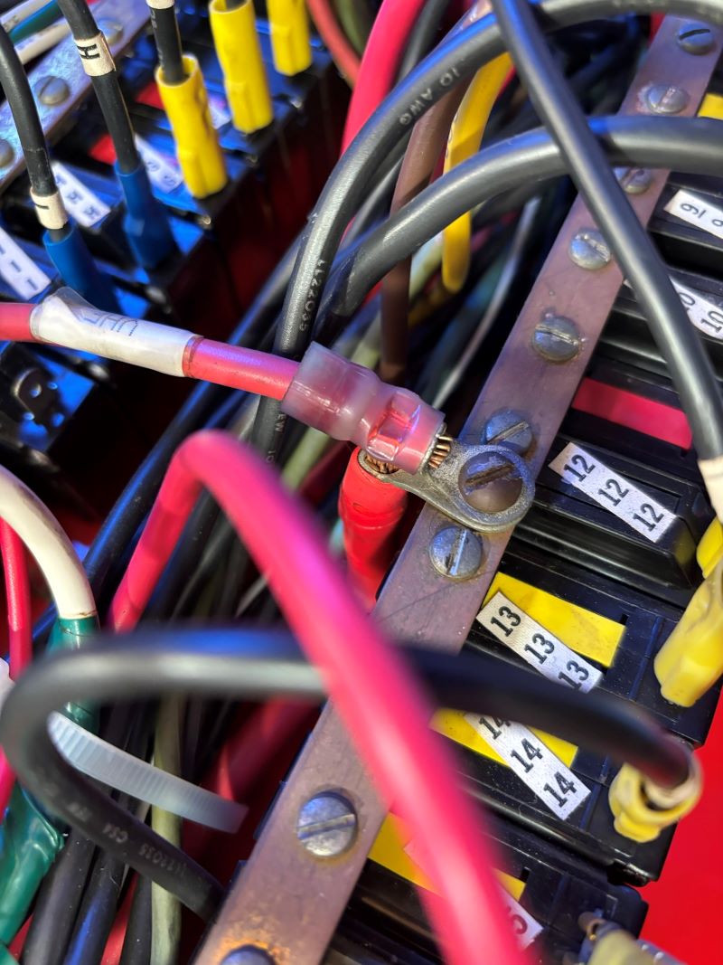

    Our DC breaker panel buss bar has two 6 ga cables coming off the buss that are not on breakers.
    One I know where goes, it goes to a breakout in the overhead box that the VHF's and the fwd top lights connect to. That lead has a fuse in it inside the breaker panel.
    The other has a 90 degree end and runs to the very bottom of the panel cable bundle and I can't see where it goes even within the breaker panel enclosure.
    With all the breakers off, those two leads have power. With the DC Main also off, they are unpowered.
    Do any other owners have anything similar that could lend some light to the second/unknow lead? I haven't been able to locating anything I know of that runs on DC that is "ON" when all the individual breakers are off but the DC Main is on. When the DC Main is off I get an open circuit on my DVM from the buss bar, at the cable attachment point, to DC ground (when the equipment in the overhead is switched off).
    Here is a photo. If anyone knows or has a guess where that cable may go I would appreciate any leads.
    Thanks

    I'm surprised by the draw from VHF's and shower sumps. I guess I need to check mine. I've also never seen a dual connector like what you have in your photo. Why would that be used when you have plenty of room on your buss to land the wire with it's own connector?
  6. Pascal
    8,897
    The only reason for a heavy wire to be attached in the back of bus bar like that is to power that bus bar. Or to tap power for another sub panel somewhere, maybe up in the Fb

    Buss bar is powered by the DC main breaker at it's end (not visible in the photo). The 6 Ga wire running direct from the top of the buss bar goes to a junction block in the overhead. I'm sure the Ga selection is from the original 1980's radar current requirement (it is fused just off of the buss bar connection). It is overkill for the 2 VHF's currently running off of it (each with it's own local fuse at the junction block). The current XHD24 radar connects to a different junction block on the flybridge, which has it's own breaker off the buss bar. The original purpose for the wire coming off the bottom of the buss bar is still unknown, however it shows no sign of being connected to anything.
