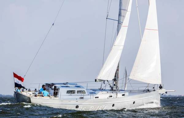

    Boat is Besteaver 45ST. What’s that? Aluminum cutter rigged sloop from KM yacht builders in Makkum Dutch land.

    Alloy hull will last a lil longer not connected with other boats on the same dock.
    Still, I hope your survey included hull plate inspections and thickness testing.
    This may be a similar model.
    gr8trn likes this.
  11. gr8trn
    gr8trn Senior Member
    Dec 3, 2012
    807
    OR/CA
    Yep hull ultrasounding, although that is usefull, insurance likes it too, it's hard to shoot the ultrasound on the entire hull so like moisture meters, hull tapping and the rest it is done but not 100% guarantee.
    As for the boat, that may be a sistership for sure. That is for sure a Bestaever by KM Yachts.
