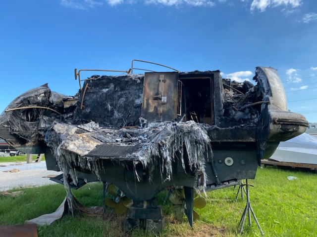

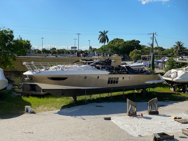

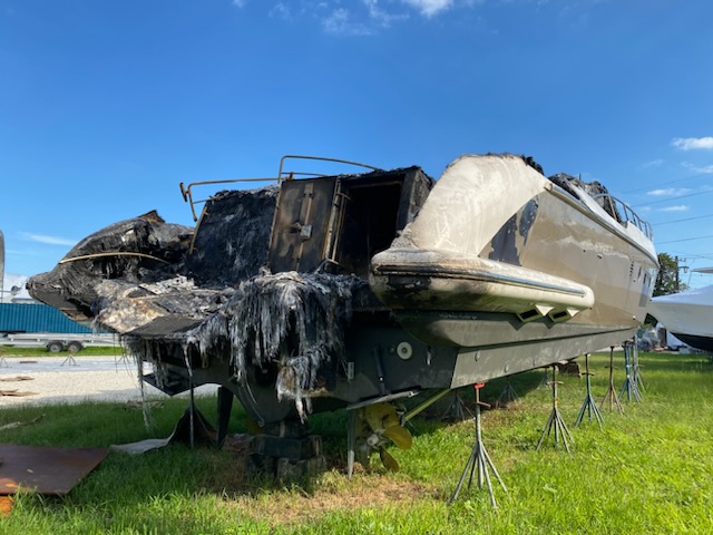

    Speaking of fires this is one of our neighbors in the yard this week.

    That is the Azimut 70 which caught fire in Aventura in end August or Early September.
    A Sunseeker 75 Yacht from 2005 caught fire here in Malta in 31 July.
    http://www.poweryachtblog.com/2022/08/out-news-sunseeker-yacht-burned-and.html
    Speaking to a survey locally who is reviewing the incident, they are thinking it started from the Invertor.
    I think when yachts are beyond 2/3 years old (especially of a certain size) it comes down to who is working on them.
    Saying all this, I have seen old type battery chargers fitted to 2009 or older Sunseekers.
    With a weak battery, these are known to go a bit Awol and cause a fire for example.
