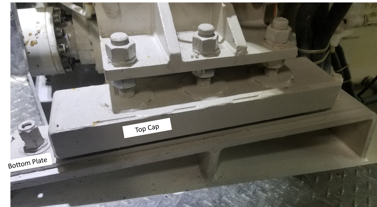

    Yes, agreed. But I'd like to understand what is wrong, regardless.
    A visual of all the bolts associated with the motor mounts (just now) didn't show anything obviously loose. But I'd like to better understand what I'm looking at:
    What's going on between what I've labeled "Bottom Plate" and "Top Cap"? For example, is there rubber in there bonded between the two?
    The reason I'm particularly interested in the motor mounts is that my mate noticed the other day that the exhaust was really bouncing a lot, and it happens to be supported by a vertical post coming off the rear outboard motor mount on this engine.
    As far as damage during shipping, like I said, who knows. I do know that it was loaded in Ft Lauderdale, moved from the rear of the ship to the front in La Paz, and then offloaded in Ensenada. Lots of handling.
  8. TahoeJohn
    TahoeJohn Member
    Aug 8, 2020
    155
    Tahoe VIsta
    Okay, makes sense. Since I'm a newb on this stuff... to check alignment, does that involve removing all the bolts on the shaft-to-gear coupling and then using feeler gauges in the gap at 12, 3, 6, and 9 o'clock?
  9. NYCAP123
    11,205
    That exhaust is a good tell-tale that would point me towards the alignment or mounts. That should be a rubber plate although it could be separate bushings. I've been on a couple boats when the engines were realigned and it seemed a matter of trial and error, but maybe someone who's actually done it can chime in on that. In the mean time maybe you can have your mate watch the gap at the mounts and compare the movement.

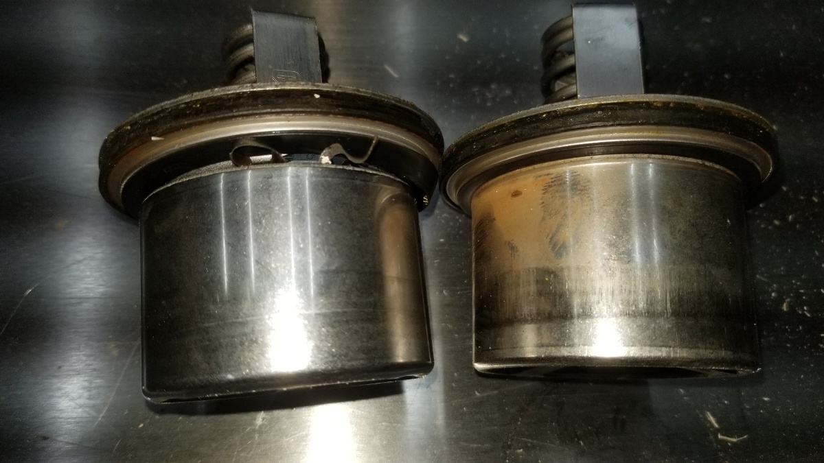

    Thanks for checking in. I haven't made much progress on this issue... I'm currently in the middle of replacing both thermostats in that same engine, as it wasn't coming up to temp during idle. I did find the problem:
    On the vibration, I don't think it's the engine itself as it runs through all rpms very smoothly with the gear in neutral. My next step will likely be to have it hauled out and see what that reveals.
