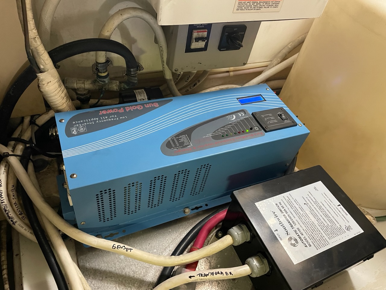

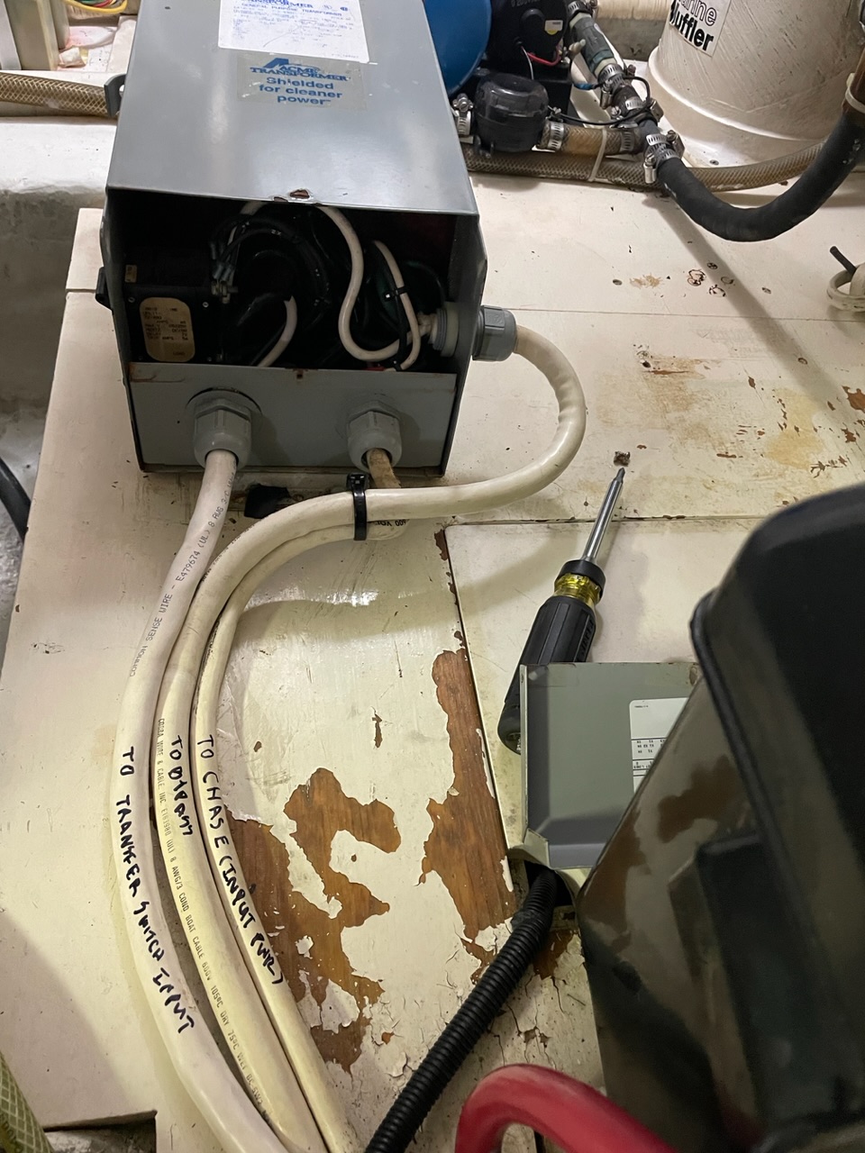

    here’s pics
    One pic is the automated transfer switch, inverter, and the bypass switch (mounted on the bulkhead)
    Other pic is the transformer, with the access cover removed

    First; Great place to install ACv equipment :confused:.
    So, what does that manual transfer switch do?
    Oh, by a few other decals, I know that inverter box.
    Pretty good up to 3kw. Square and full wave forms.
    I don't see the big path between these devices and your panels.
    Or, is that one of the issues??
    Is there any support from the previous owner or surveyor??

    in the foreground of the image with the inverter there’s a black box - “southwire automatic transfer switch”
    In the background of the same image is a box mounted on the bulkhead. It has an inverter (output) on/off breaker and a 3 way switch - on/off/bypass for the inverter
    If you are inclined to zoom into the images, or if you can even zoom in that far, you may see I’ve labeled the wires with sharpie. But the basic AC flow is
    shore power to transformer (and separately to main panel)
    transformer to transfer switch and bypass switch (2 outputs)
    Genset to transfer switch (and separately to main panel)
    Transfer switch to inverter
    Inverter to bypass switch
    Bypass switch to main panel
