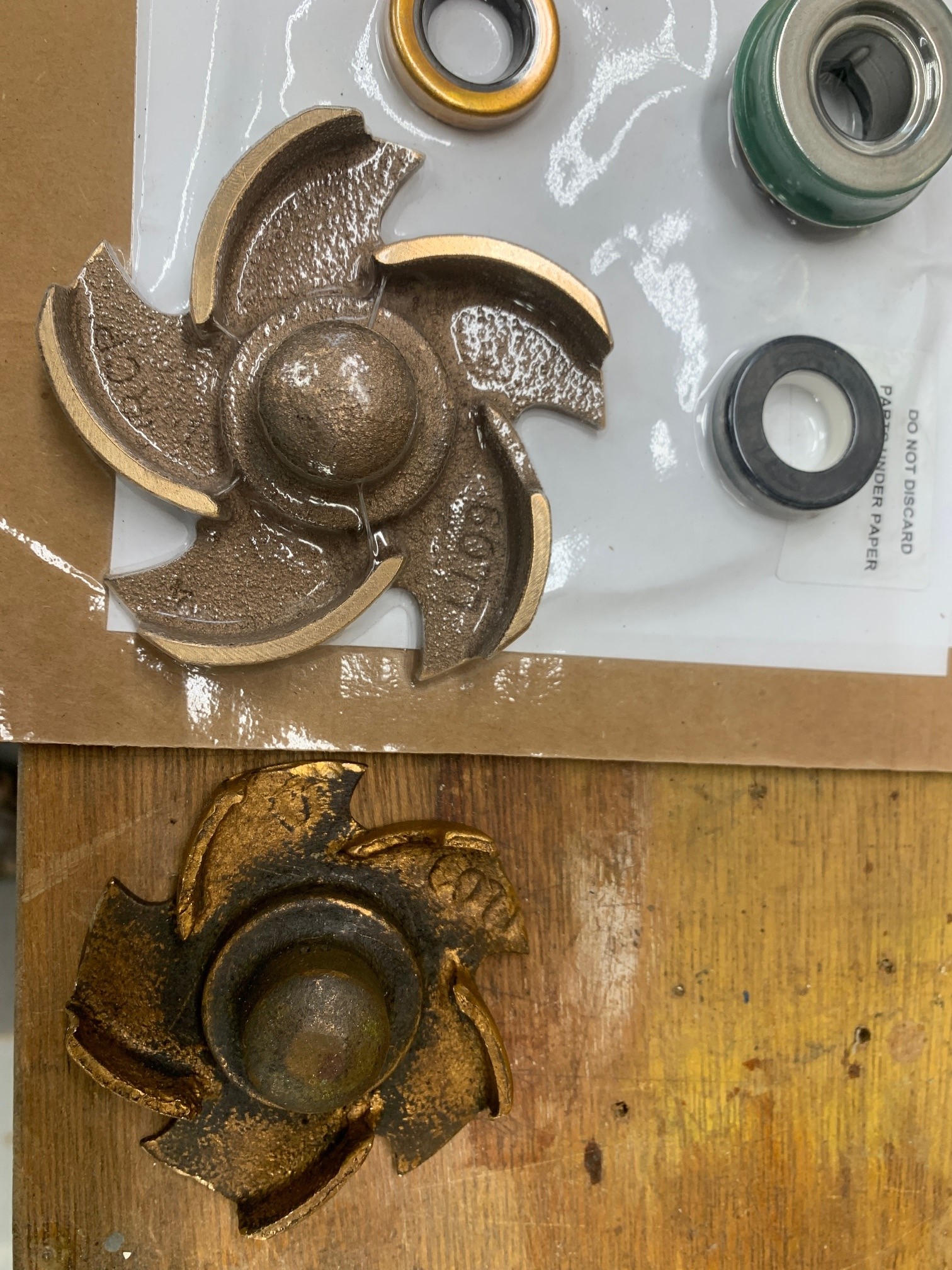

    If you have a Brass/Bronze pump you may want to check the impeller on the pump.
    Last summer on the hottest day all three A/C units went off on high pressure. Further investigation revealed the pump. 1/2 HP 230/1/60 was not outputting much water from the two above water thru hulls. After checking strainer (clean) and prime ( it was primed) pump was pulled out. After disassembling the front cover we discovered to brass/bronze impeller has worn down to approximately half its original size. See picture for comparison. Impellers.jpg Luckily our local marine wholesaler (shout out to John at Midwest Marine Supply in St. Clair Shores. MI) had a brand new Oberdorfer pump and motor in stock. Not cheap, ouch. Re-installed and Voila all air units started up and function like new. Checking with previous owner he had not done any service to the pump. As a precaution, a rebuild kit for pump and new motor are ready for service as a backup. Like most problems on large boats keep your eyes, ears and wallet open. :)

    Problem is that usually you also have erosion on the pump housing so while a new impeller will help the pump will still not pump what it should. Even worst sometimes the housing develops a pin hole.
    I ll never use a bronze head pump ever again
