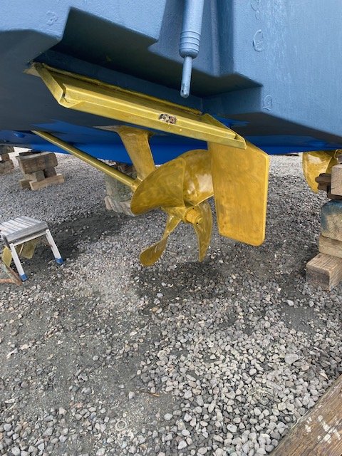

    Have the boat out of the water now so going add an 1" or 2" wedge

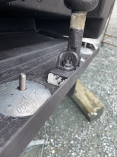

    This is a photo of a 43 Cabo convertible trim tab. The hydraulic ram has been disconnected to apply the prop speed. My 40 Cabo convertible needs very little tab to get up on plane, however the hull is quite a bit different when compared to a 43.

    The 43 has no problem getting on plane. In a loaded condition the stern is just very heavy I doubt adding tab angle helps much but we'll see. Side note prop speed isn't worth it, stuff comes completely off the wheels in a few weeks, it does last longer on the rudders and shafts

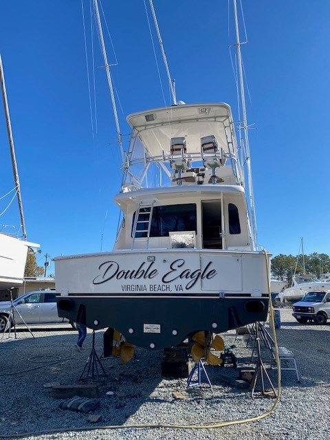

    I had prop speed applied to my Cabo 40 last fall...this is the first time I have used this product and am not sold on it yet. We shall see how it holds up. I plan to check it later this summer.
  13. Ben Cooksey
    Ben Cooksey Member
    Oct 10, 2020
    45
    Mobile AL
  14. butch w
    butch w Member
    Sep 27, 2022
    43
    Arnold MD
    What material is the wedge made from? Thanks for the update

    Add 1" spacers, they do very well on that hull.

    Update: this wedge has made some difference in a loaded condition running, the boat does have some bow steer when its light so I back off tab to 1/2 or 3/4
