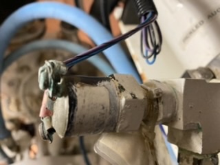

    Just as a follow-up to this topic and so I don’t create a separate thread, I had another one of these wires break Off the terminal from fretting and am going to look at replacing the sensor.
    Does anyone with a 50 Post with Man’s know who makes this sensor? I can’t find a part code in any of my books and it is worn off the sensor which is located on the heat exchanger for the transmission gear oil. This is what triggers the Man alarm for gear temp. I will also reach out to Bayside Diesel but I wanted to ask if anyone knew off their head.

    Just wanted to close out this topic as I have finally found the replacement sensors thanks to Performance Diesel. It turns out they setup all the MAN packages for Post back in the day and certainly for my 2000.
    The part in question is a temperature alarm switch, part number TM-2C-203R/20. They go for around $85 as of March 2021.

    If you loosen the wire and use a tie wrap to secure the wire to the sensor you will improve the reliability of that connection. In the picture that wire appears taught and will vibrate and break. The tie warp take the strain off the bare copper wire at the connection. It's a good idea to do this on every connection on the engines.
