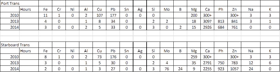

    I recently received my oil analysis results for my transmissions. The boat is a 2000 50' Post with ZF IRM350PL transmissions. When I look at the trend of the starboard sodium readings and molybdenum, I notice that they are starting to increase. For comparison I also included the port transmission values. Anything to be concerned about? Trans oil cooler leak? The boat has been in fresh water for 3.5 years. Thanks

  2. Capt J
    14,887
    Is it currently in saltwater? When was it in freshwater? What are the rest of the readings for the sample? Are you sure the place that is checking the samples is doing a good job? Because I find it really odd the port trans has zero values for the sample

  4. Capt J
    14,887
    It's obvious that it was a long time that the gear oil was changed prior to 2010 by your readings. I honestly wouldn't worry about what you're seeing now. 24 PPM of sodium is nothing and could be from a drop of sweat or etc. All of your readings look good from what I see and all of your wear metals are low.

  6. SFS
    SFS Senior Member
    Oct 4, 2013
    122
    Tampa
    Short of asking questions directly of the lab that did the work (what analytical methods were used, what the QC results associated with this specific analysis looked like, and getting a feel for the strength of the lab's overall QA program), it's difficult to assess the quality of the analysis. If it is a reputable lab, that does a lot of this work, you should be able to trust the results.
    As a QA chemist with 35 years in labs, I did notice two things that are noteworthy.
    1) The concentrations of many metals dropped between the 2010 and 2013 samples. This could be the result of an oil change, but you speak above about "the prior oil change to 2010". Am I correct in assuming the the oil was ALSO changed sometime between the samples analyzed in 2010 and the ones analyzed in 2013?
    2) The way that the results have been reported for calcium (Ca) and zinc (Zn) changed from 2010 to subsequent years. For 2010, the results were reported as greater than 300 (which is not very helpful, as the result could be ANY number greater than 300). For the two later years the results were much more precise, and covered at least one more order of magnitude. There are several potential reasons for this (many of them technical), and you can PM me if you're interested. However, the most likely reason for the difference in reporting is a change in the lab your mechanic used.
