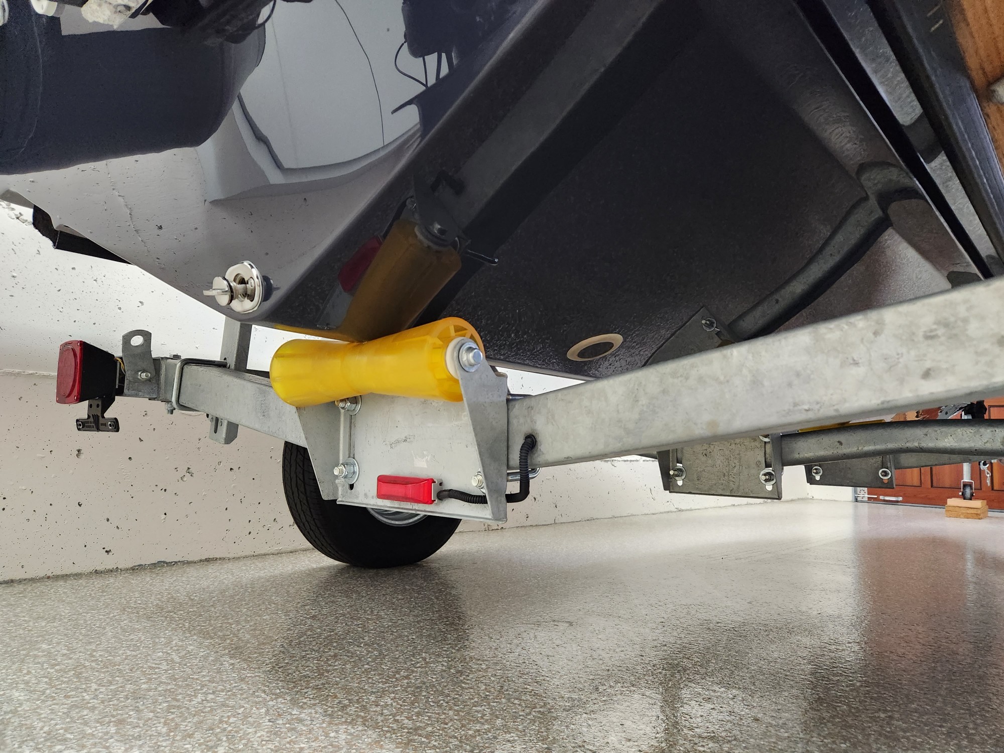

    I upgraded my dinghy (Novurania 430DL) from a 2001 model to a 2016. I took my Simrad NSS7 and Airmar P79 thru-hull transducer from the old boat and installed it in the newer boat. Now the transducer won’t work thru the hull like it used to. If I hold it over the side in the water it works perfectly. But I cannot get it to read when in the mount on the hull. It is installed properly and has the required propylene glycol in the mount. I don’t know if Novurania switched from a solid hull to a cored hull and if that is giving me problems? I couldn’t find any hull info online to speak of. Anyone have any ideas or recommendation for a different xducer? I prefer to not use a transom mount xducer due to my chock arrangement when it’s on the bow.

    It is odd that same xducer worked on other boat which is exact same model but was 15 years older. Hard to imagine they changed their manufacturing and went to cored for a RIB boat. And the weight of the boat is similar to old one. I may try to relocate the xducer to another location and see if I get same issue. I guess it is possible that I somehow got lucky on the old boat and found a more solid spot it read through. If relocation doesn’t work it looks like I have a hole saw in my future :);)

    I really can’t use a transom mount. I have a stopper chock that the transom butts up against to make loading easy. I could put one off to the side but I’ll bet it would get busted off the first time I went to load the boat.
