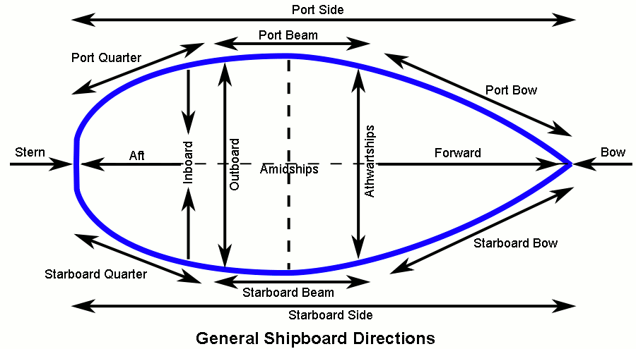

    'the ducers should be abaft one another'
    Athwartships,not abaft
  5. P46-Curaçao
    P46-Curaçao Senior Member
    Mar 8, 2013
    734
    Learned a new word (Athwartships)...and found the answer myself...yeahhhh
  6. Berean
    Berean Senior Member
    Aug 26, 2007
    303
    Sarasota FL
    Now that's a cool diagram....
