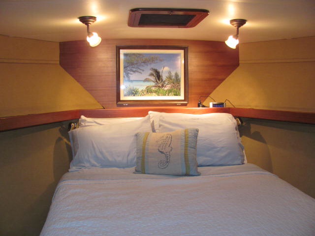

    I don't remember exactly how I removed the mirror. I think it came off in pieces. I replaced it with teak veneer plywood, framed a picture we took in Bimini, put a stainless piano hinge on the top of the frame and catches on the bottom. All of which covers the door for the anchor locker and swings up and out of the way for access to chain in the locker.

    one bad thing about YF is all the ideas I get for improvements.
    Your work really updated the master S/R.
    This is now on my list of things to do.
