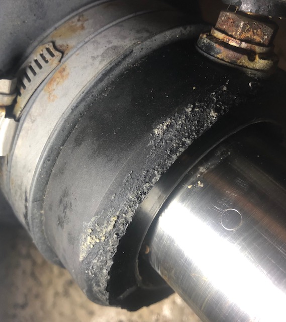

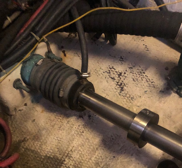

    Does anyone have good advice regarding shaft seals IMG_2638.jpg IMG_2641.jpg
    These PSS seals are 6 years old and were adjusted in July of 2019 about 60 hrs running time since. The Starboard seal leaks at speed 16oo and above on sea trial. PSS recommends assembly replacement at 6 years and these are right at 6 years old. The yard foreman assigned to my WO says he sees them last up to 15 or 20 years and suggests perhaps cleaning and adjustment based on over all condition might just be in order. The mechanic has yet to see them. I removed the battery shelf and cleaned the shafts up and moved the rotor back so he can inspect them and make his recommendation. I had Tides Marine Sure Seals on my 44 and for five years and 400 hrs never had a drip out of them and I liked the idea that should I have had an occasion to replace a seal I could just install the one in the spare carrier on the shaft. I'm interested in your experience as to life limits on the PSS or whether you might consider replacing with Tides Marine seals.

    I am having PSS installed on a boat that had tides and spun one of the tide seals crimping the hoses and frying the entire assembly (which I've had happen on 5 different boats, maybe more). I have had good luck with PSS. Sounds like you just have tension issue with yours. Yours look REALLY crusty and S/S corroded for only 6 years old.

    In your pictures I can see some scuffing and wear lines in the composite surface and a stain or two.
    I also see the set screw mark on the shaft and the bellows has not expanded.
    The PSS (and old LasDrop) installations will chatter and leak when dirty. Water stains (pollution and tanic ) and silt/salt will cause this.
    While in the water, I fold a length of W/D 1000 grit and sandwich the paper between the contact surfaces. With water coming, I can lightly polish the contact surfaces and clear these stains & debris. Don't get carried away, just evenly all around a few times. You may feel the drag reduce some. The older bellows can use some more tension after 6 years also, especially in cold water.
    On the hill, Maybe some fine water based lapping compound, spinning the steel color by hand against the composite surface.
    Hand polishing with dry paper I never tried and not a fan of recommending it.
    Cleaning well, some impeller or water based greased on the surfaces, lil more tension on the bellows and lock er down.
    Remember to keep the shaft clean and lube the shaft so the internal O ring inside of the steel collar does not get damaged or deform when sliding up/down the shaft.
    File down that set screw burr on the shft to help that O ring also.
    Dial out the collar when the set screws are tightened down. No mater what is said, There is room for the collar to tighten down and not be perfect square with the shaft.
    There should be two set screws per hole. The second screw (just snug) locks down the first.
    Also consider a nylon or marelon injector fitting. Looks like your steel hose barb has a rust stain on it. Where there is rust, there is a weak component.
    These have sunk boats before.
    The big clamps could be renewed now also. Please consider using Aba or good T bold clamps down here. You may sleep better.

    Based on your photos, I don't think you need to replace those seals.
    Just follow Capt Ralph suggestions, and I bet they'll last another 6 years or so.

    Thanks for the response. I measured the total dimension of the bellow with the rotor slid back and sitting overnight. The bellow is compressed about 1 3/8 inch form the dimension new. I have decided to replace the bellows since the boat is on the hard. I am comfortable with the condition of the carbon seal and I will be replacing the barb fitting as the kit comes with a new one. I should be set for a few years.

  6. Capt Ralph
    12,649
    Very good.
    Don't forget to clean up the set screw marks and any scratches on the shaft and get new O rings for inside the collar. Lube the shaft up on re-install.
    Square up the collar and go fishing.
